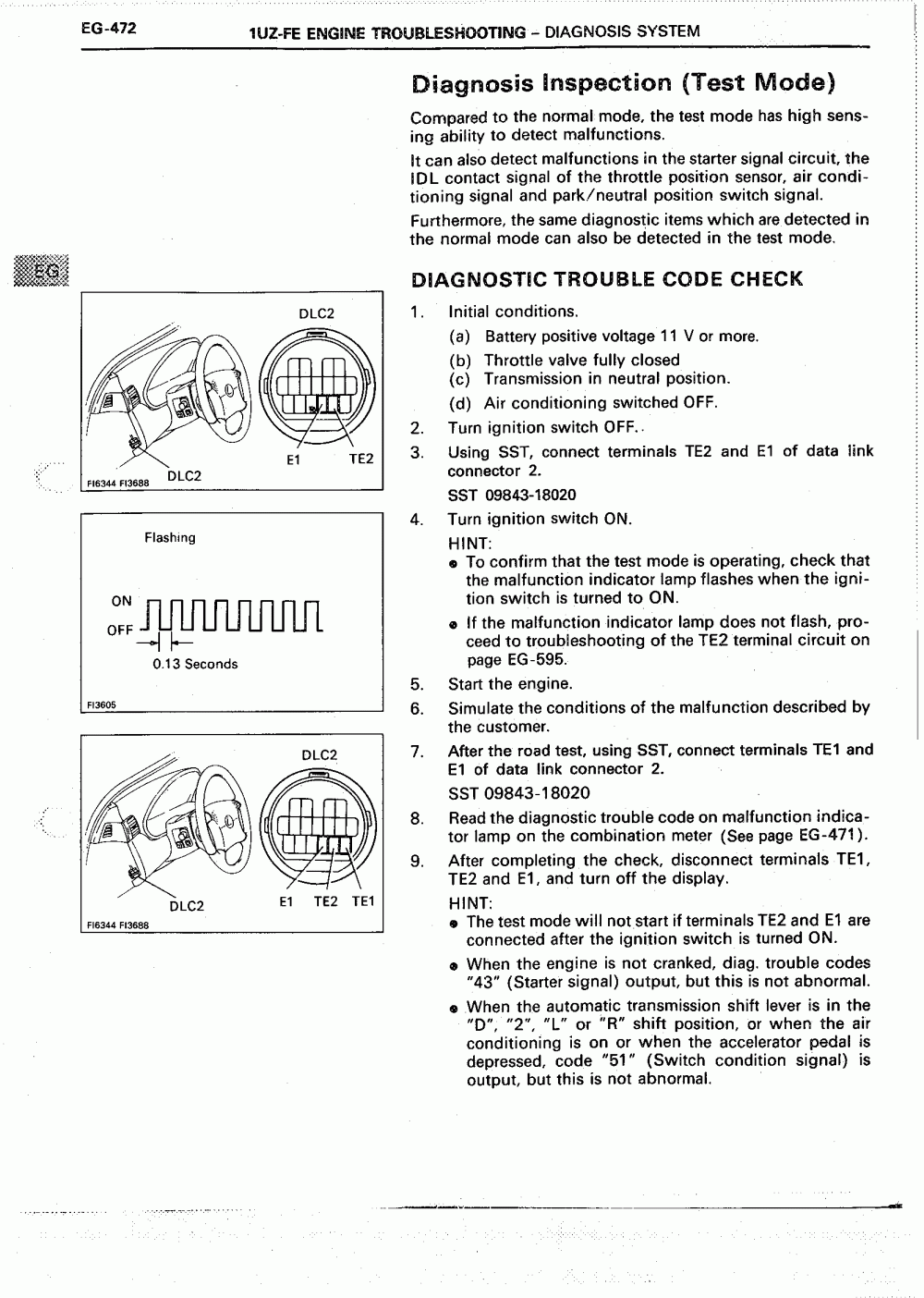

Hi there,
I’ve recently bought a 1993 Soarer 1UZ. An “Engine issue” text translated from Japanese is popping up but the engine is running perfectly healthy. When bridging TE1 and E1 in the Diagnostics box and turning on ignition, no check engine light pops up at all. My Tc to E1 works fine so I know the bridge itself should be touching fine. Just really not sure what I’m doing wrong. Anyone able to help?
