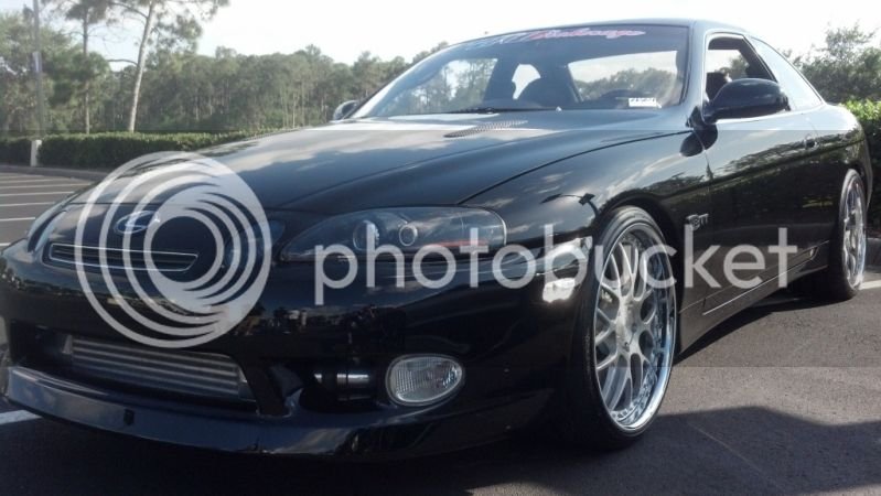

Q: are those HRE wheels? I have the same pattern on my Supra and really like them. I think the 'vette's were the first to have that pattern, and I think they're great looking wheels.
Thanks for the kudos. They are not HRE. They are 360 Forged. I too, Love my wheels.

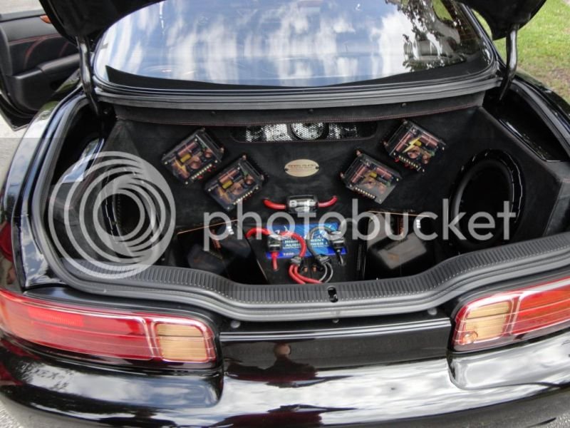

I tell you, the new stereo is stunning, but I knew that changng out the stock 97 tails to the ClearCorners 97 Tails would be a bear...And it was. In order to get to the tails, I had to remove and disconnect the rear 12" subs, as well as loosen and unbolt the Sub boxes. Plus in order to get the sub boxes moved enough to provide me enough clearance, I had to unbolt the amps and move them out of the way as well...It took me 10 hours to get that completed. But it is done and the Clearcorners are installed!! I will have pics soon and post up.

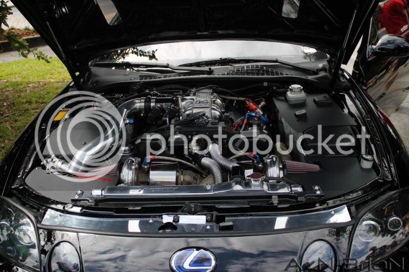

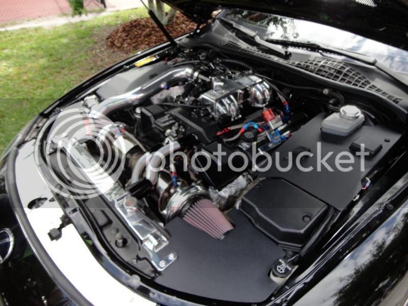

Ryan how's the engine coolant temp doing in your Florida summer?
Remind us again which radiator & which fans you're running?
John, In the limited time I have driven it, it has been great. I will know more once the alternator is replaced, and the final tune completed.
I am running the Koyo all aluminum radiator built for the Supra, a custom aluminum shroud and the SPAL low profile high velocity fans.''
