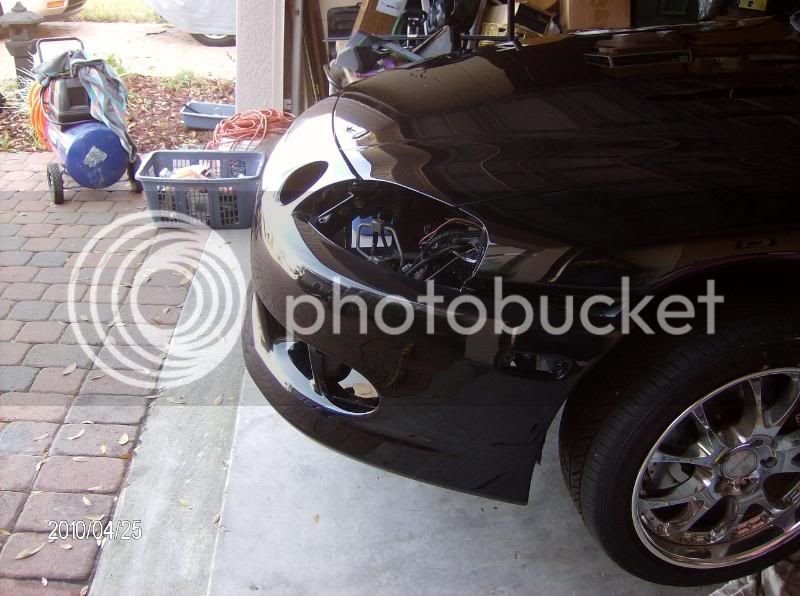

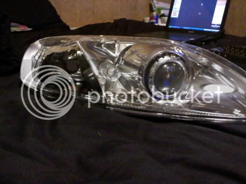

Hey gang, I mentioned a while back that my headlights would go through a major special conversion, and get the Supermade clear lens cover. Here they are with the stock lens removed, and the new Supermade lens placed over the light for mock up purposes. Remember that I already converted my headlights to true HID projectors from the Audi TT, added the BMW Xenon Ring to fill the gap in the Lexus housing and keep an OEM appearance, plus manage to keep the lights fully adjustable. These should really update the appearance of my SC. I will post more as this goes along.
Driver Side:
Passenger Side:
I am real excited about this custom mod...Modernizing the look of the car while maintaining much of its original look from the 2000 model year vehicle has been an important goal to me. Can't wait to see the final project.

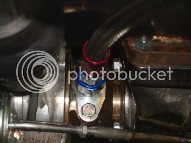

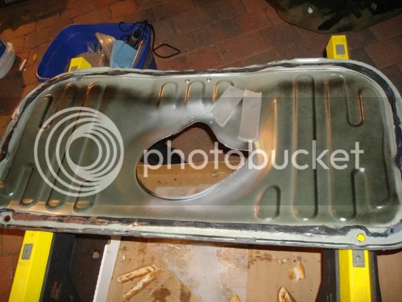

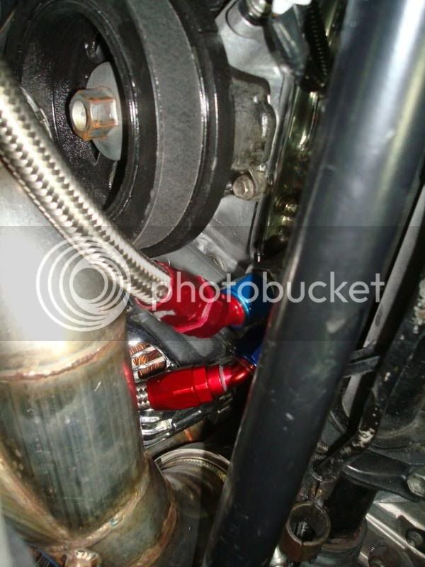

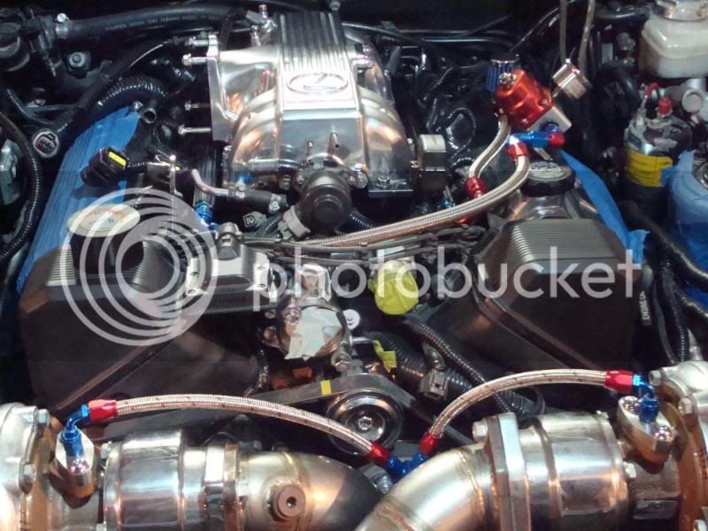

Here are a few pics if the oiling system...
Frontal view:
Closer:

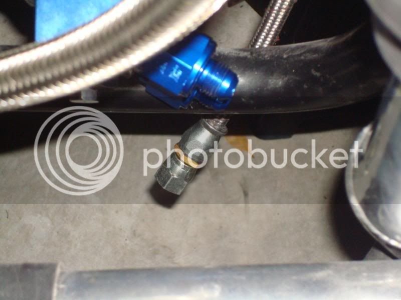

Oil feed off the sandwich plate:
Another of the feed:
Return at Y on upper oil pan:

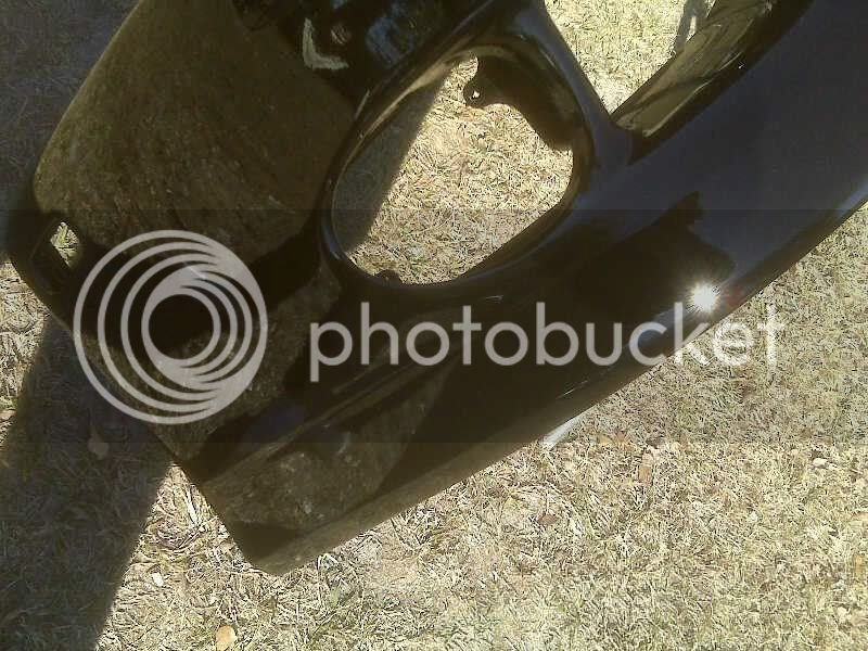

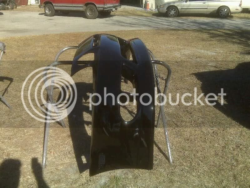

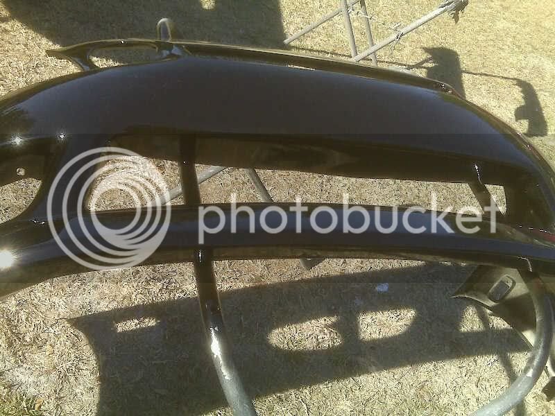

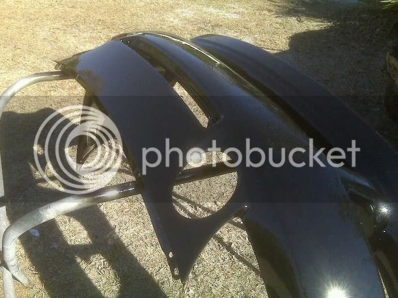

    • Here are a few pics of the Bumper and the Hood...
      More coming...

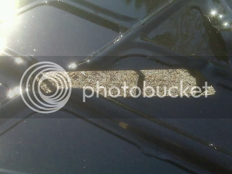

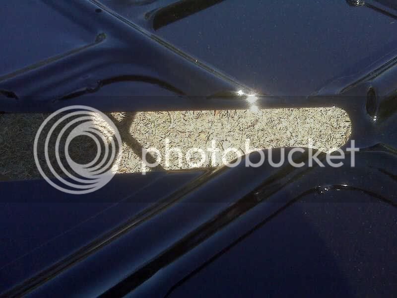

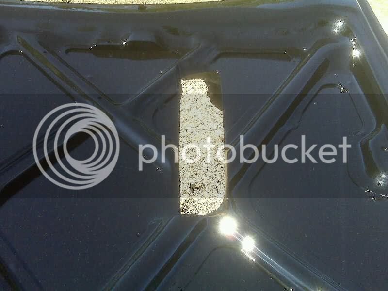

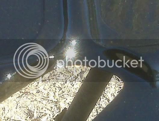

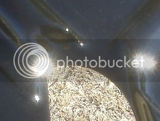

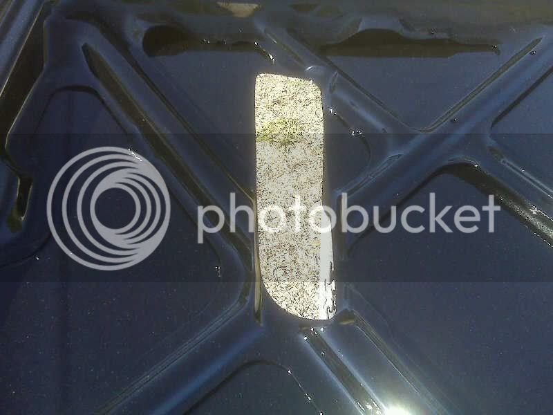

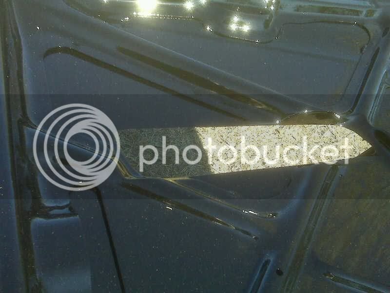

Pics of the underside of the hood...When the slots were cut out of the hood, the the reinforcement frame was cut in some areas as well. It caused the frame to separate from the hood in a few areas, as well as left gaping holes in the frame. They had to be filled and re-attached to the hood, as well as have the appearance of an OEM look (my anal-retentiveness...:sadance: ). It was important for these holes to sanded and filled properly. The painter, Jack Gonzalez, went well beyond my expectations...Great job Jack!!
Here are some pics of the hood (just the underside):
Thanks,
Here are a few more:
Last ones...I cannot wait to complete this project...Sorry for the poor camera pics...My cell phone took the pics...

  • The Turbo oil feed has been completed
  • The Turbo Oil return has been completed
  • The External Oil Cooler has been installed
  • The External Transmisssion Cooler has been installed
  • The high Pressure Oil Sandwich Plate configuration has been designed, built and installed (Whew, what a pain)
  • The Fuel Return Line has been completed
There is still much to do...I will keep you updated...

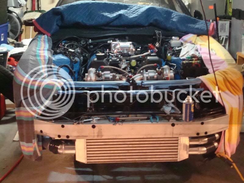

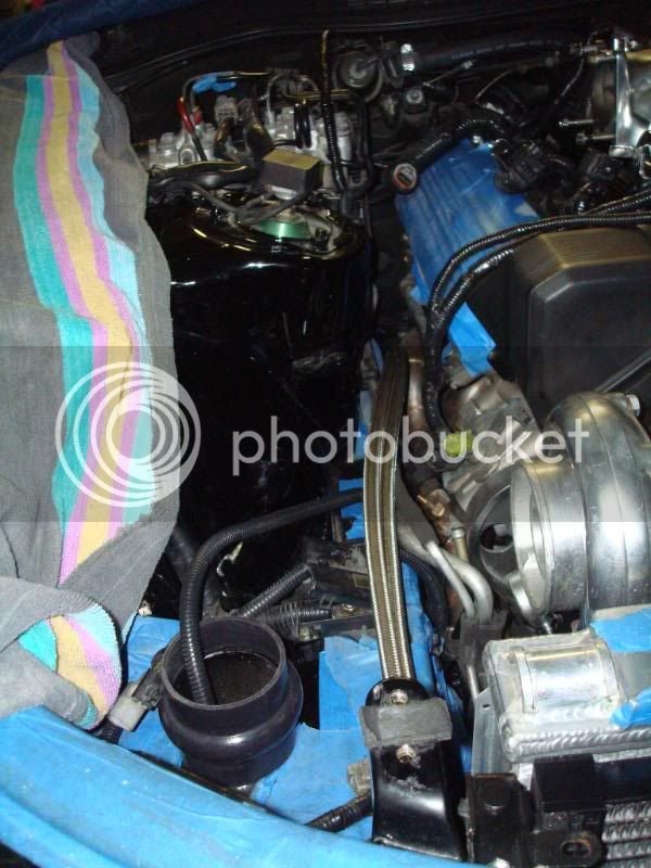

Removed the turbos, the manifolds and the downpipes so they can be ceramic coated. What a PITA!! Had to loosen the motor mounts and jack up the engine to remove them. They go on Monday.
Here are some pics of the recent work.

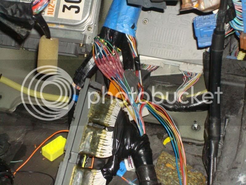

This is the reconnected Autronic harness:

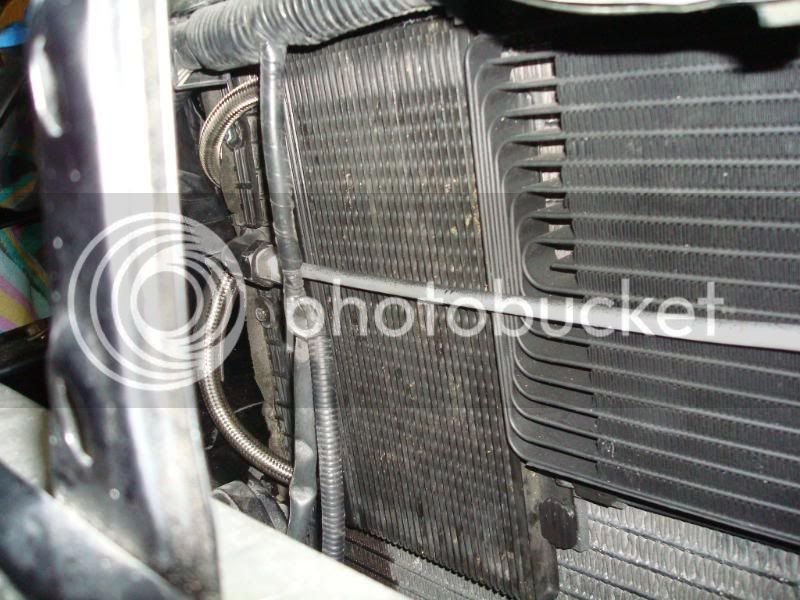

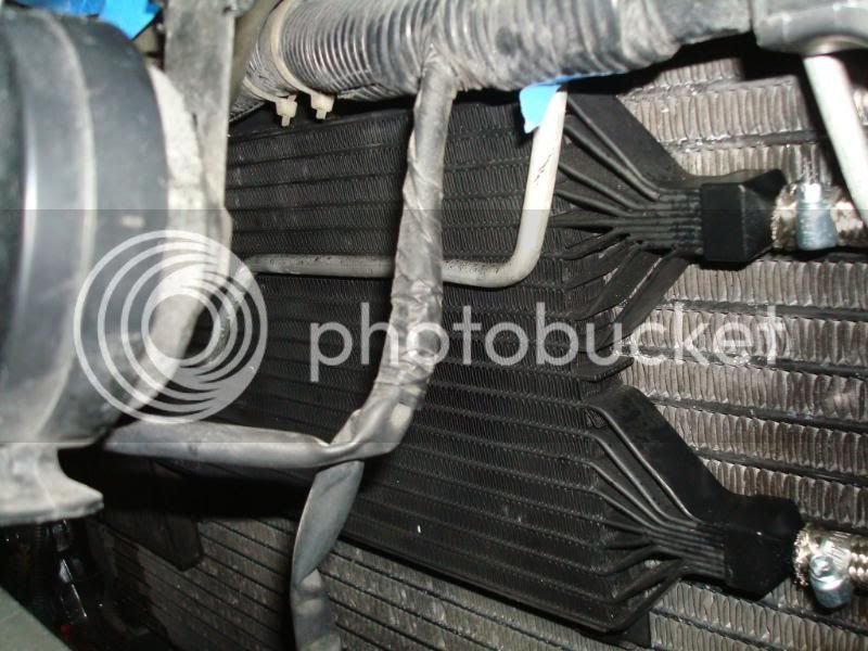

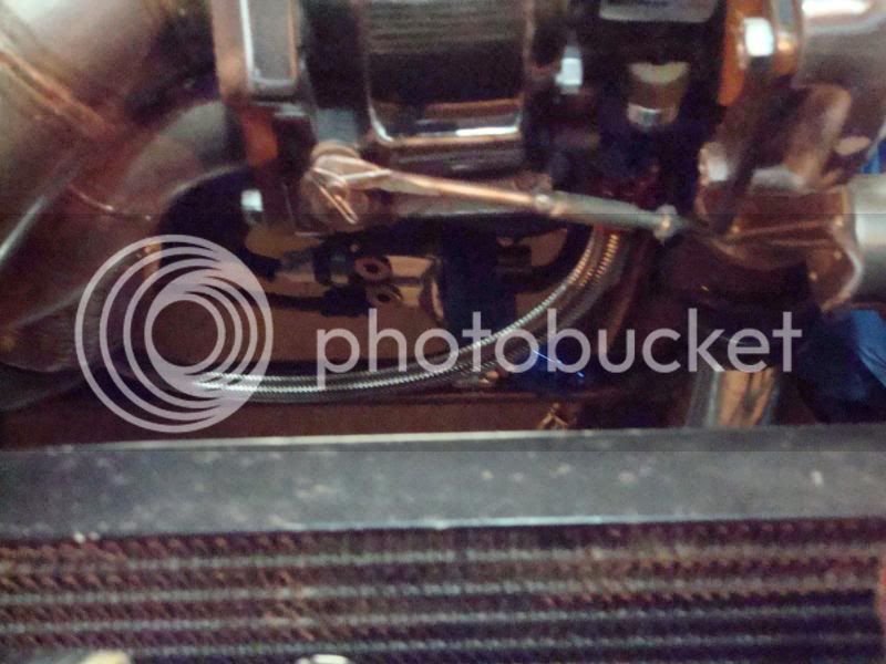

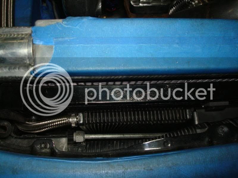

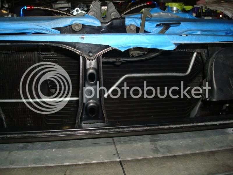

Here are the two external coolers connected:
The oil cooler:
The tranny cooler:

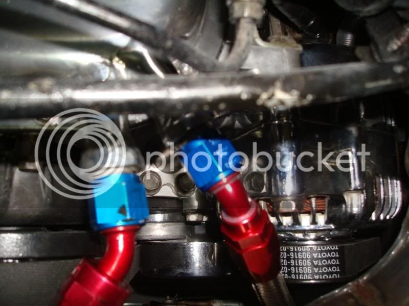

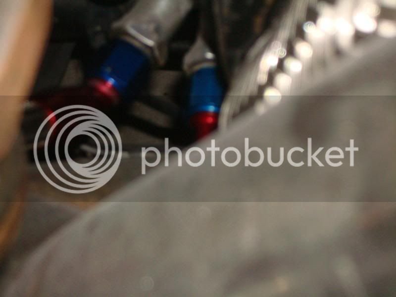

Oil cooler feed and return lines:
More coming...
Top view of the oil cooler:
Top view of the tranny cooler:

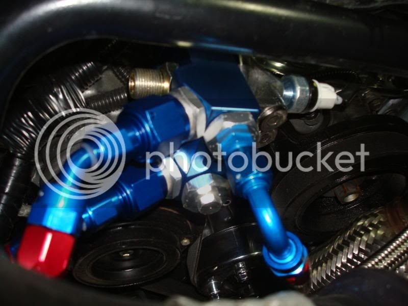

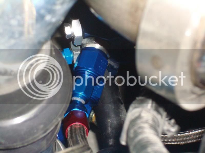

Oil cooer feed and return line on the sandwich plate:

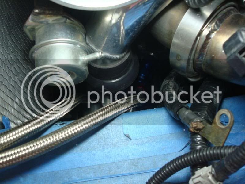

The whole high pressure set up showing the sandwich plate, the oil cooler feed and return connections and SS Braided hose:
The transmission cooler feed and return lines:
More...
Oil return lines from the turbos:
Another pic of the oil return:
Return coming out of the turbo, nice straight flow:

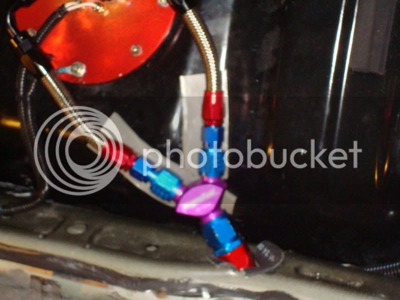

Fuel return Line:

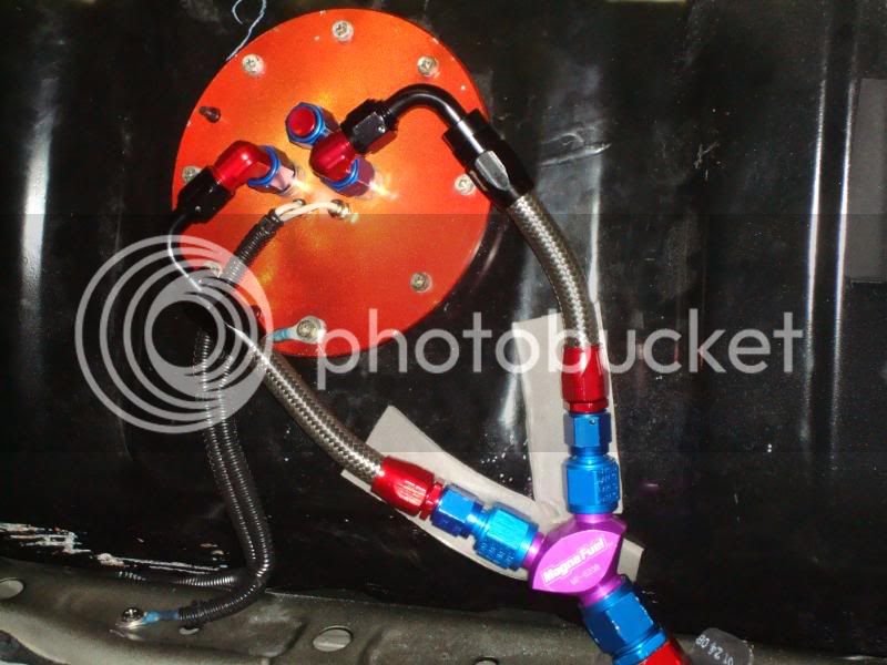

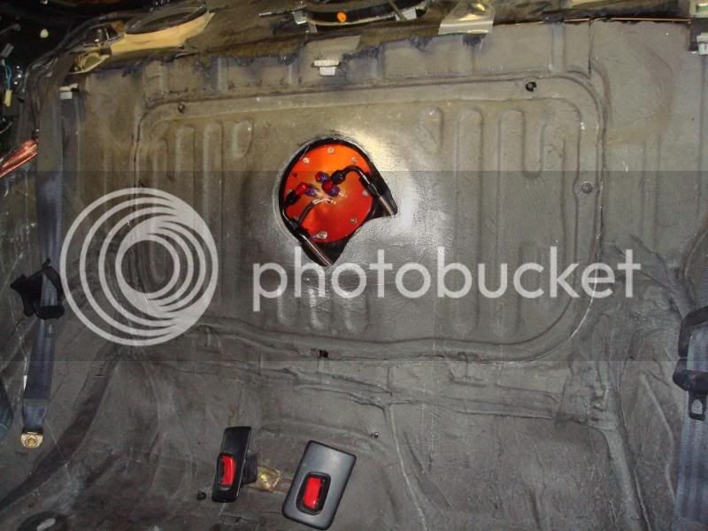

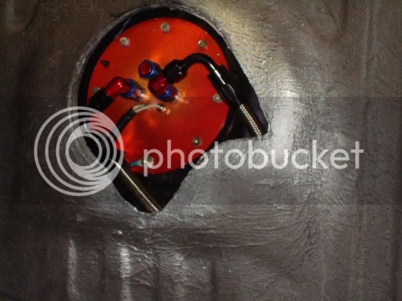

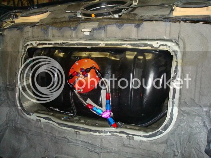

Well, the fuel system is now buttined up. We completed the braided hose and connected them from the 2 Walbros to the *** Fuel pump hanger access cap.We had to wait a week for the access cap to be modified because the nipples on the inside were not long enough, nor did they have a bead welded on the ends of them to help keep the fuel hose i place once connected. The nipples were also far too short for my taste, so I had -6 weld on An's welded onto the short nipples. For added strength and security, the nipples were also threaded so the weld on's could be screwed down on them first and then welded. They will never come off. Kudos to Eric for making the whole unit as it was a first quality item in spite of the miss on the short nipples. He did tell me about them after I bought the unit.
We also had to modify the firewall access port so that the braided hose would fit under them, so we cut out two small sections for clearance. The adges were then sanded and painted to smooth the edges and keep them from rusting.
We also added Toyota FIPG sealant on the fire wall access panel to reseal it all around. We also added some neoprene to cushion the fittings and to dampen any potential rattles. So there is no metal to metal contact.
It turned out well...

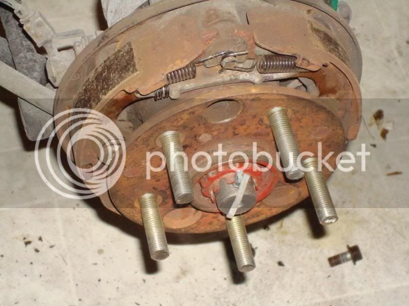

Also got the parking brake shoes reinstalled, as well as those very painful tensioners...Unbelieveable to reinstall those tensioners until I made up my own tool to re-secure them. Then it only took a minute or less to reconnect them. I also installed the longer ARP wheel studs that are made ffor the Lexus IS. We cut off the excess so they would fit my application.
All in all, it was a good day working on the car. I will receive the ceramic coated headers and downpipes next week so I can re-install and get this car ready for starting.
I plan to fill the car with fluids and start it for the first time next weekend...Hallelujah!!

Here's some pics of the work just completed:
Firewall access panel after cutting, sanding and welding.
*** Dual Walbro fuel pump hanger installed.
Fuel lines installed and system closed.
Close up.
More coming...

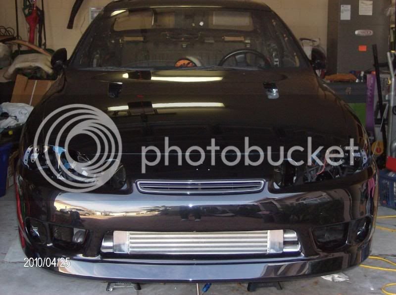

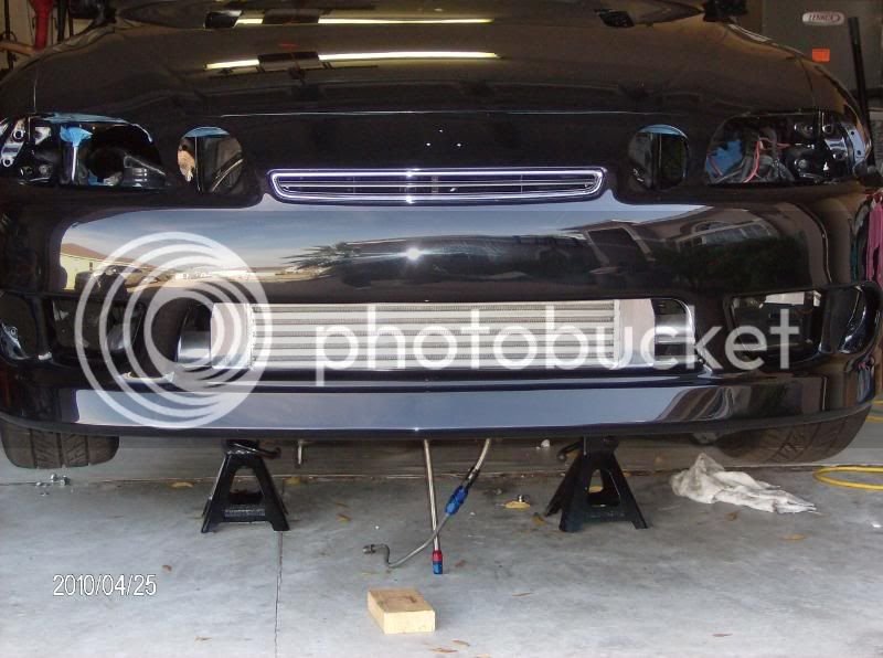

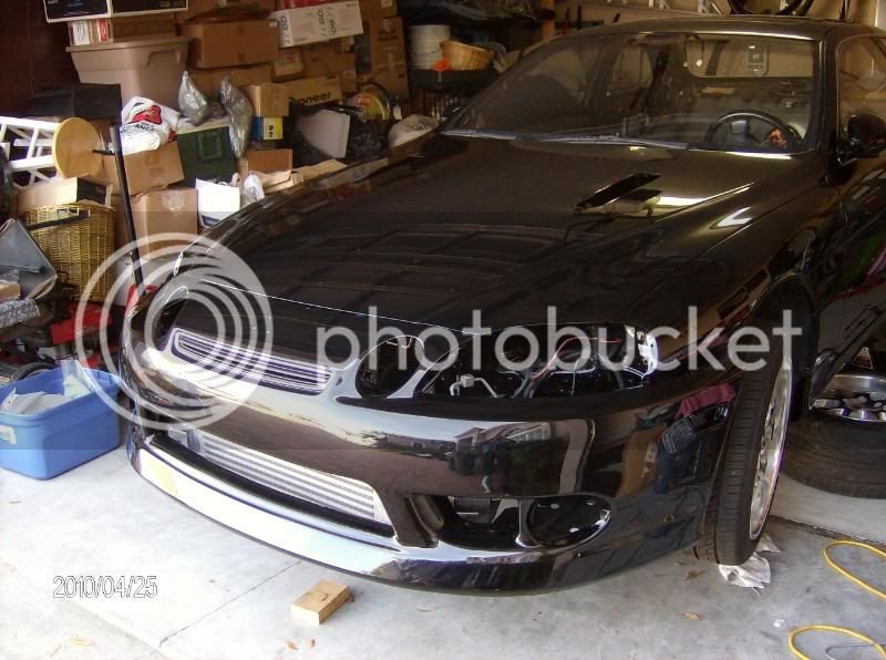

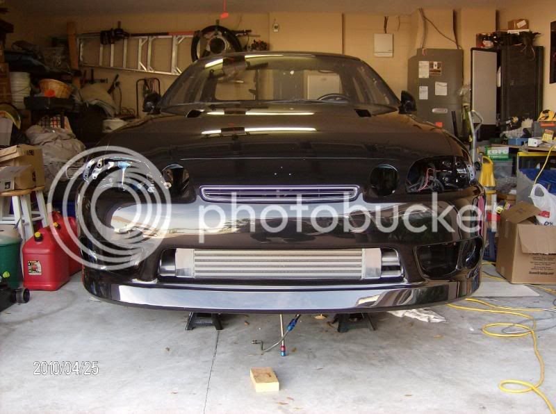

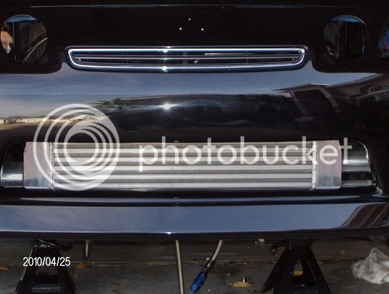

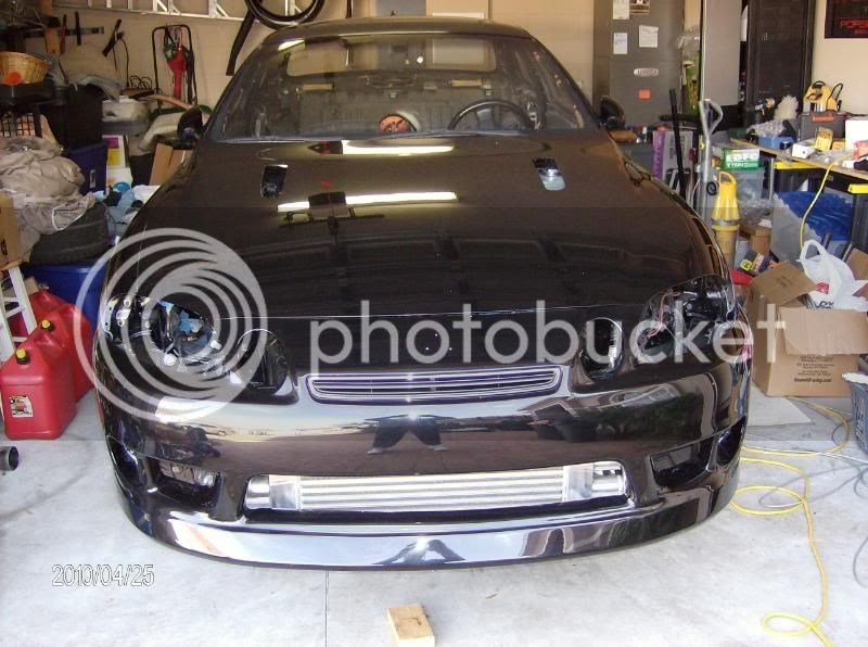

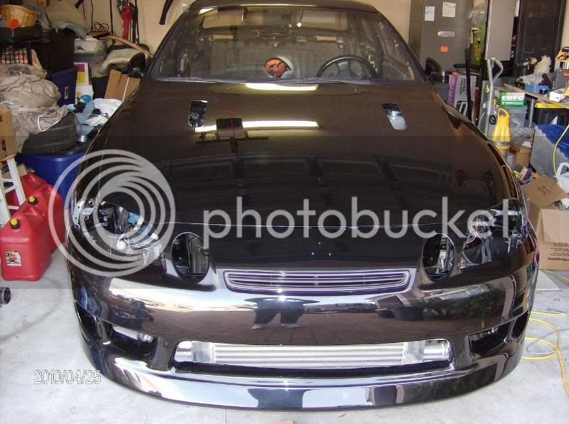

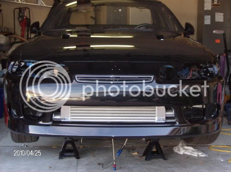

The hood and bumper are here!! I am very pleased with the work. Since I still have a little bit to do, and to fabricate the water pipes, I decided not to install them just yet. I did place thom on the car to take a few pics and to show you all the craftsmanship of the paint and body guy. The slots in the hood for the Aston vents are simply sick!! IMHO!! I hope I am not interpreted as bragging when I post up with excitement. It has been a long haul, and at times I wondered if I would ever get this project done. Almost there, and very elated with the results so far. I hope you enjoy...
Don't mind my garage...It is a disaster...
That front end is gorgeous Ryan - first time I've ever felt I needed to put on sunglasses just to look at an Internet photo!
The hood looks great too. Very understated and elegant.
