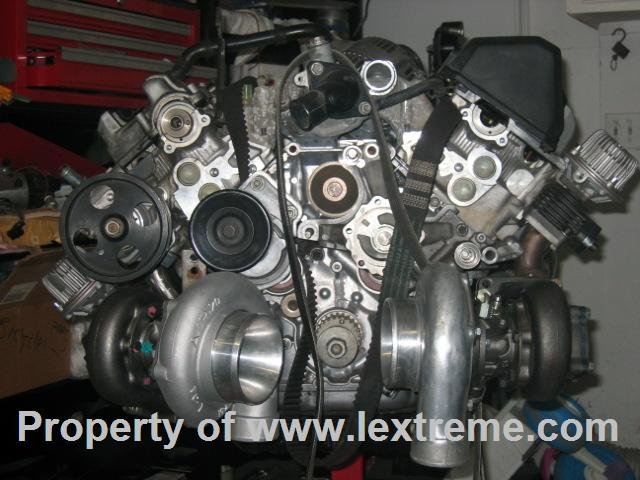

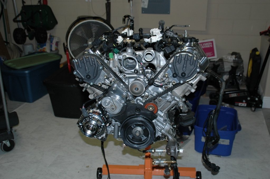

That TT motor looks awefully mean there Lex buddy... But again will that twin setup clearly outperform a properly fitted single turbo on that same motor? Does it really make a difference....
Looks awesome though...I am sure it will perform well too..
A T04Z / .84 A.R or .96 A.R will perform admirably on the Lex V8.. If they spool nice on a sohc 4.0 Ford 6 ? They would on a 4.0 V8 ...
The plumbing is much the same. Either crossover for cold side for twins or crossover hot side for single... Depending on intercooler design....

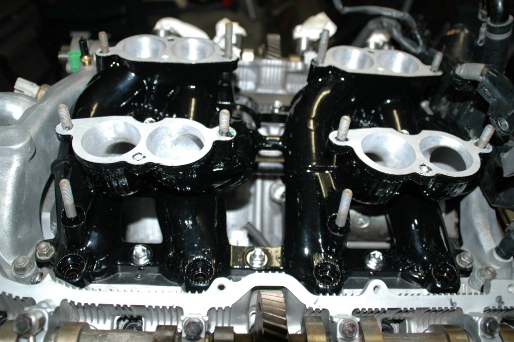

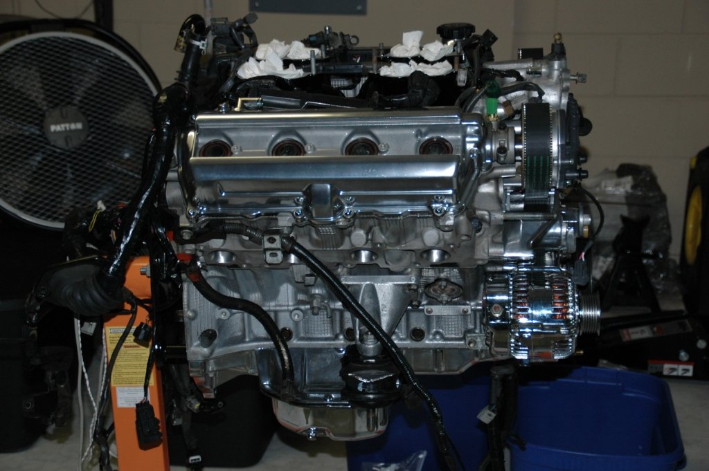

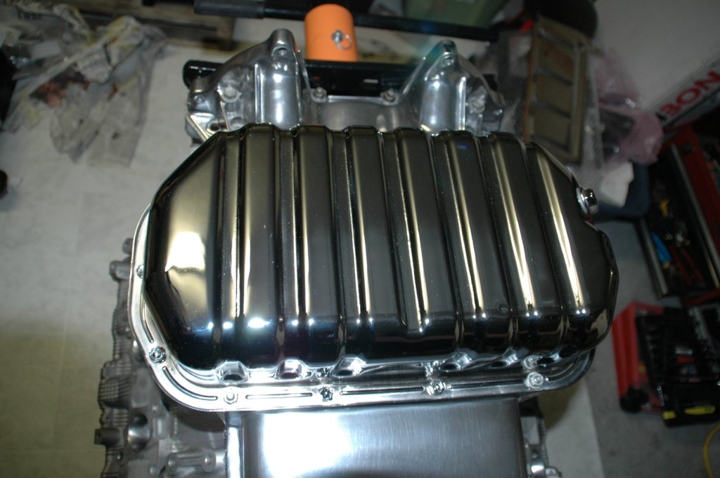

Here are a few more pics of the install:

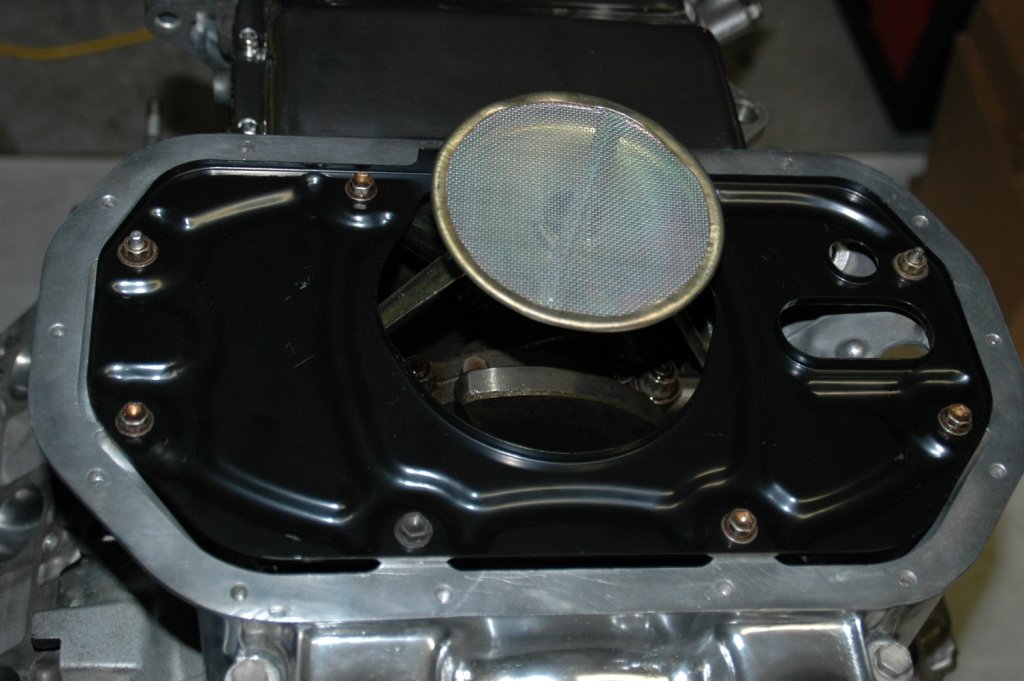

Installed the Baffle:
Installed the lower oil pan:
Another:

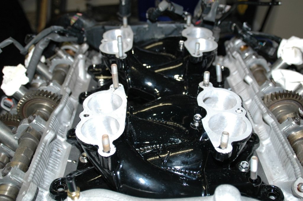

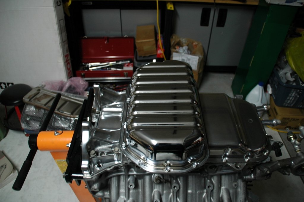

Installed the Black Powder coated Lower Intake:
Another:

How are you going to fit air filters on the turbos with them facing eachother?
The turbos are on opposite sides of the front of the motor. They are not facing each other, so there is plenty of room for the air filters..
Ryan
Alright those lower intakes are clean and smooth inside and out just like mine! You have a very generous engine porting dude. Looking forward to seeing what will be done with the upper. Looks great! I almost didn't coat my lower but I'm glad I did.
Hey Smitherz, actually, those intake ports are scuffed up quite a bit on the inside so that wwe can increase the turbulence for optimal fuel/air mix.
Thanks, Scott. I do try...
Ryan
Yeah my guy did mine the same way. I should have said they look shiny. Feels good to know it's super clean inside and out.
