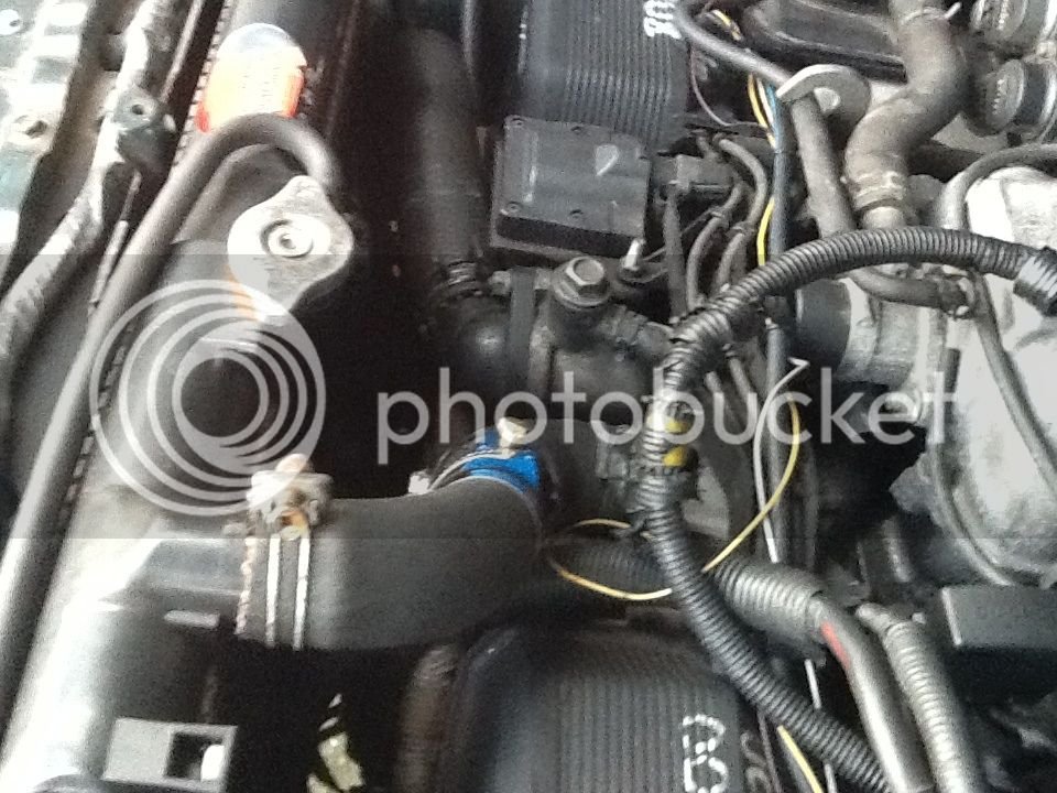

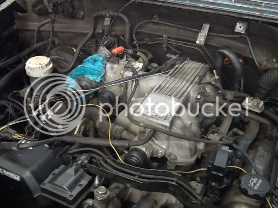

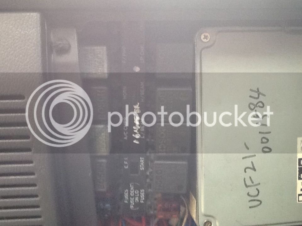

Have had a play today ,while I wait for my resistor I changed the wiring to reflect the resistor being in circuit .motor wouldn't start like it was starving for fuel . The pump would time out which was a good thing but I don't think it was running during start up . I tried it with the pump wired direct and she went fine, so I think the two relays that control the pump are de-energised while in start , so might try again and wire a relay that runs the pump while starting then let the ECU take over once started . It's all good fun , one thing I do like is how the ECU shuts the pump down when the engine isn't running , it just has to learn to run the pump on start I guess . Here's another vid of it running

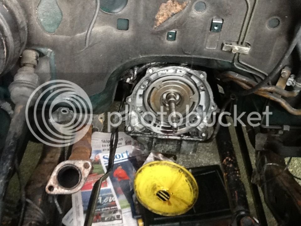

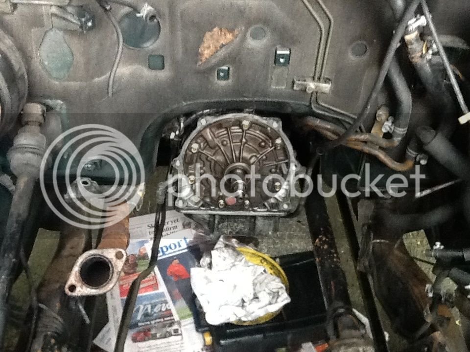

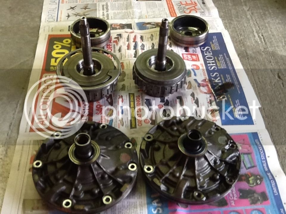

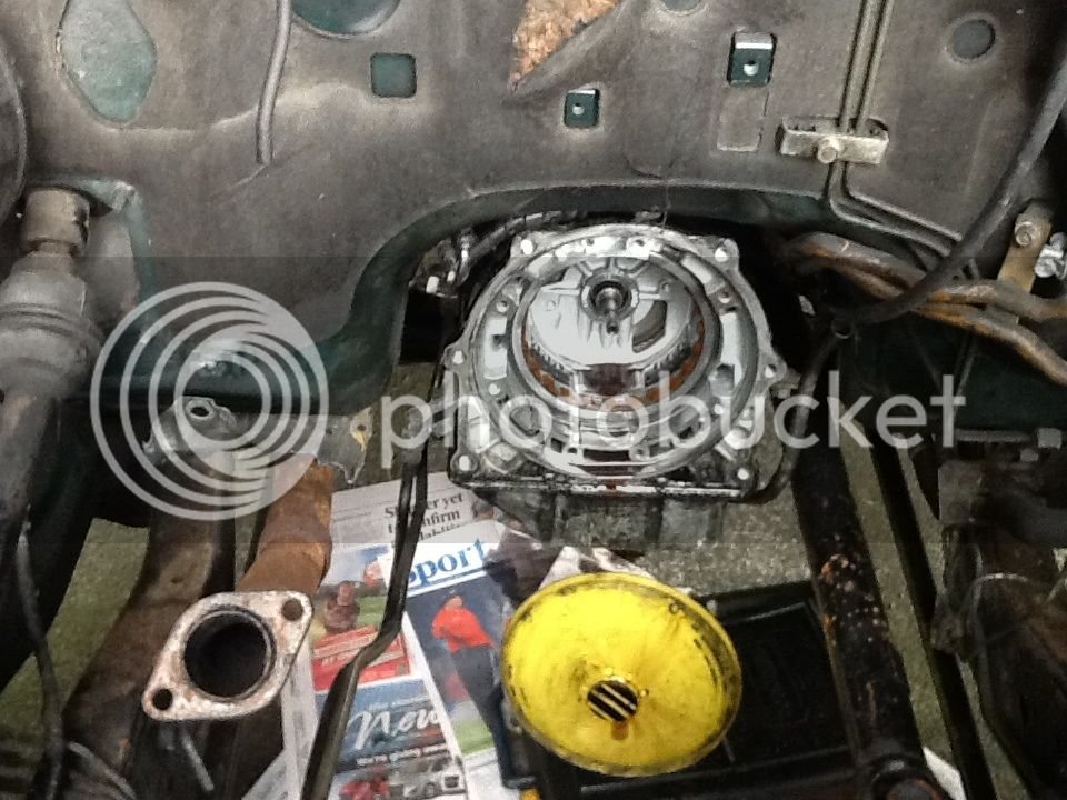

The other day I swapped out the Pajero gearbox parts and put in the Lexus , the first pic shows the parts I changed , the longer input shaft of Lexus Can be seen on the left
The following pics show the pajero box with parts removed and then each Lexus bit in place

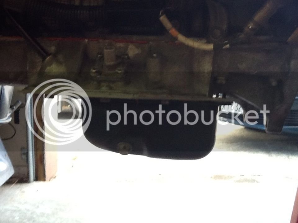

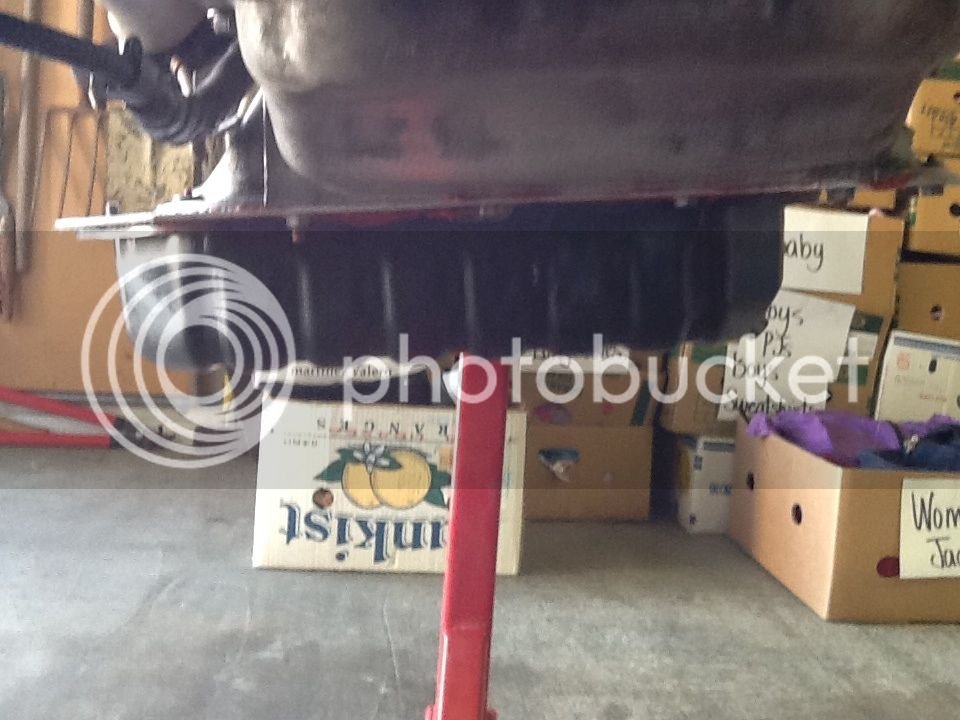

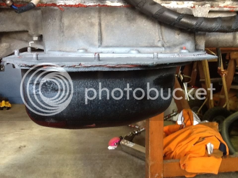

Thanks to Kobi ,I have a rear sump , I've made an adaptor plate to avoid the front diff ,dipstick still works , needed to use my slightly extended oil pick up but all good , hopefully trial the motor in position soon

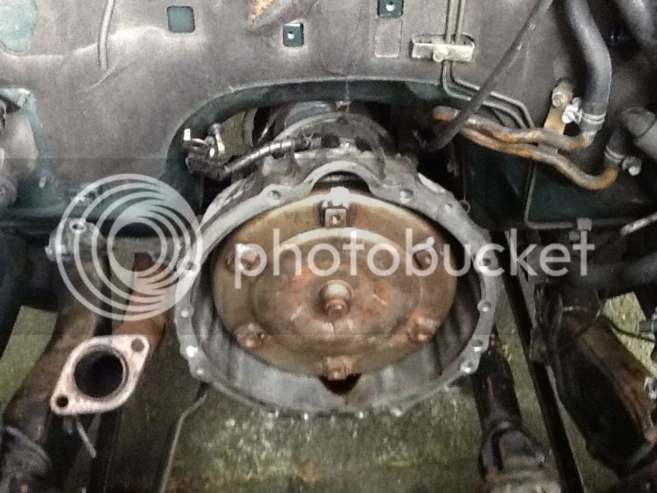

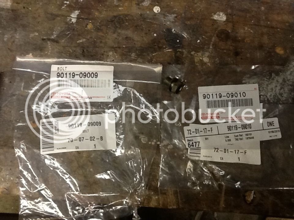

Here's the part numbers etc for the flex plate to torque convertor bolts , 9mm x 1.25 thread hens tenth in NZ ..........$5 each to . They sell them as 5 gold ones ( not real gold !) and a black purely for identifying bolting up so you don't over tighten I'm thinking
pajman
Member
Messages
156
Location
New Zealand
Ah I see I bolted it up laying underneath the car , I presume it all lined up ok . You wouldn't happen to know the torque setting of them

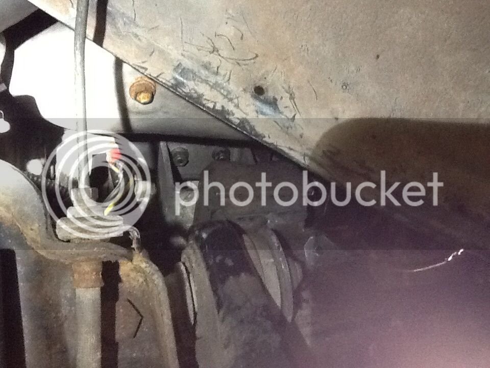

Project went quiet for awhile , but today I've fashioned some engine mounts using the Pajero ones and some 80mm square tube all bolted together I'll get them welded later on .
