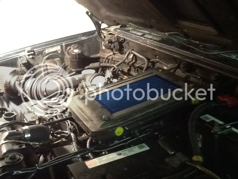

Wired in my fan controller and gauges and got the tachometer to work off the negative of an igniter and switched it to 4 cylinder . Left to do is exhaust , driveshaft loop, oil cooler plumbing ( with oil temp and fan )auto wiring as well. Then certification . I can see the finish line yay!
