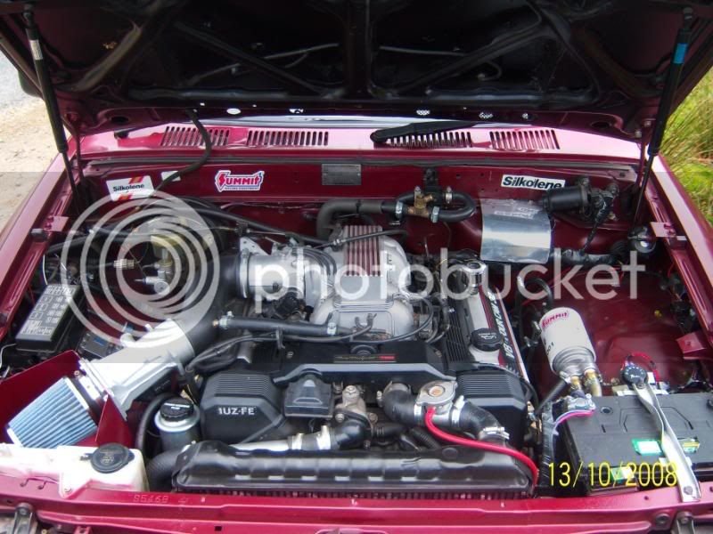

Hi all, finally finished the 1UZ install into my '91 Hilux Surf.
engine1.jpgI have an adjustable switch for the electric cooling fan but I've no idea what the normal running temp is to set it correctly, anyone have any idea?
At the moment I've set it to come on at 90 degrees
Thanks.
