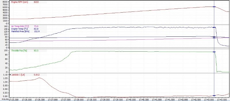

Here are my calculations.
Max air flow for 1uz @ 90% VE:
((6000*244)/3456)*0.9 = 381.25 CFM​
Max CFM * PR
381.25*1.54 = 587.13 CFM
The M112 makes 587 CFM @ 10,500 RPM
At 6000 RPM the M112 is doing 10,312 RPM
So I'd have 575 CFM
575/381 = 1.50 PR
So I should have 7.5 PSI with the assumption this engine is @ 90% VE. If we actually do the math for VE this engine is rediculous: (250*792001.6)/(14.7*10*244*5600) = 98.5%
I have the supra 315cc. Since I installed a check valve to prevent vacuum from messing up my rising rate, my afr sits about 12:1 @ 6K RPM. It used to drop to about 10:1 @ 6K rpm and idle around 15:1 :eek:.
