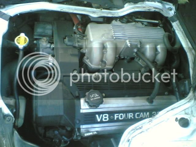

Hey Mike! Tried emailing again think something may be up with my email or something. I got another engine so am just prepping it at the moment and, if all goes well may mount it this week end . If your free an evening this week sometime you can pop round and see my vans setup? Engine sits abit high but not as high as yours does it seems.
This is the best i can do for you pics wise of glovermans set up:
I set the sump level with the engine cross member and set the engine up so when adapted with the manual box it would bolt through the stock mount. Possibly try switch the mounts from side to side and see where that sits the engine because that doesn't sound right that the bell housing fouls.
Throttle body was stripped and shaved down to the absolute minimum, flipped 90 deg and re mounted on the plenum so the cable it top mount(as per pics).
AFM should sit in the stock air box(id rather go for the link ECU so you can get rid of like 100 wires)
I actually found the hiace wasn't too bad for room, glovermans even ran a sweet set of headers.
