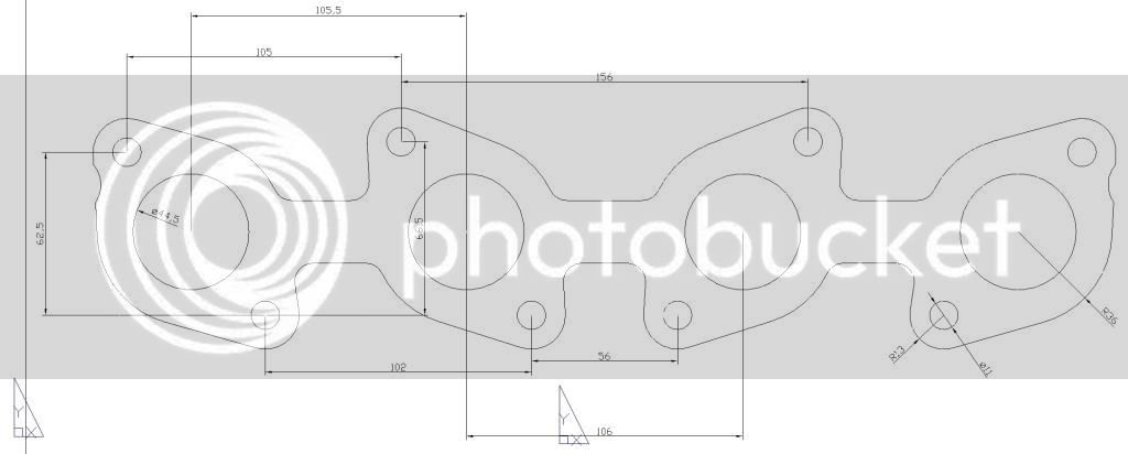

Also please make sure your bolt holes are the right size...the flange I drawing is for 8 or 10mm holes..just need to re drill them the right size for your application..cheers

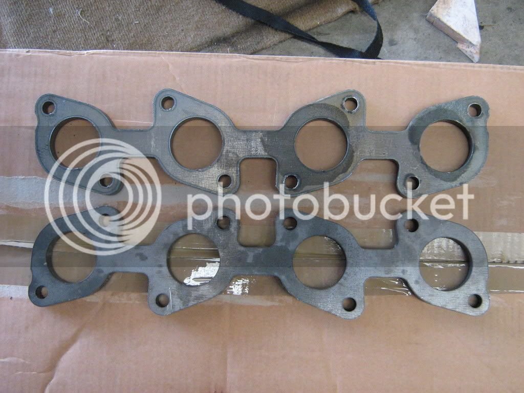

Hey guys,
i downloaded this .dxf file ages ago form somewhere on this site.
i e-mailed it to my local laser cutting dudes and hey presto:
Ive attached it to my post.
Ive really no idea where i found it.
but it works pretty sweet.
Daniel.

As the file name would suggest 1.75inch is the ID
perfect for 38NB steam pipe. which is what i used
FYI is it a good idea to have a closer match to the ID of the port to the ID of your header.
having a large jump/step can cause turbulence.

Hey folks,
whilst getting some more flanges made for a project I stumbled across a multiple's
of 10 discount.
So I have 3 sets of laser cut flanges for sale.
total cost was $320 NZD for 10 units.
So each pair owes me exactly $64 NZD
I will sell them only to lextreme members and probably more than likely just NZ members as freight across oceans would make them uneconomic.
Hole size is 1.75inch, perfect for 1.25inch NB steam pipe type welding elbows.
perfect for turbo headers made from steam pipe.
this time its a LJ78 landcruiser that is getting boosted. my aim is to be able to do 4x4 heli's in a landcruiser. watch for a vid in about 6 months time.
PM me for contact detail's then post here with the project objective. (pics or ban?)

Oh,
flanges are made from 1/2 inch mild steel.
I used these same flanges on my supra with 4 into 1 steam pipe manifolds and T3/T4 turbo"s with 38mm waste-gates and i have had no leaks with these flanges, I reused the 18yo MLS gaskets that my engine came with.
2 years and 2000ks that my supra has been running. Often driven like I stole it:

Looks like someone with AUTOCad skills can punch those numbers from the drawing above in and reproduce the file quickly. if so, please share here.

Quick google came up with https://grabcad.com/library/1uzfe-header-flange-1
Any watercutter should be able to use this and modify to whatever format needed. Not sure of accuracy
If this does not help, I can draw up and post
What format are those in, Dave? If I could get this in AutoCAD or SolidWorks, I can try to start making the flange available at a real value again. I think David (Lextreme) has one left and that's it.
DaveAus
3
Not sure on format of these. Didn't look too much.
I'll fire up a solid works machine tomorrow and check the file. There is some intake drawings on cad grab. Not sure on what series they are though. I'll look at these same time.
I see there is so much good info on this site though so many broken links. Has the site had data issues in the past?
Ill put up .dxf tomorrow or Monday.
