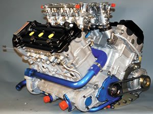

Wanna bet Jibbby. The H1 is a 2.6 litre V8 that makes 400hp n/a, i would love one of these in Striker's clubman :)
Nothing production about the h1 engine justin, it's twin busa's joind on a common cranck if I'm not mistaken.
Powertec desinged and build it, but hartley also has a similair thingy which they call their own.
cost for the engine is about 30K pounds, and rebuild every 2000km expept for endurance spec engines.
ps the H1 is allready superced with a 2.8L 455hp version, I would love to have one but not in a striker a road legal Radical sr3 springs to mind
I know of a lancia stratos replica that has one of these baby's on board, it's fenomaly quick.
but again a purpose build race engine, so not a production run like ferrari
