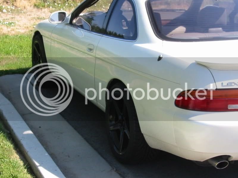

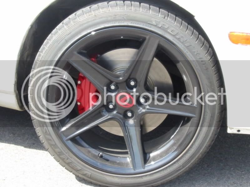

I am running the Saleen replicas on my SC400 18X9 +18 front and rear and they clear the LS400 calipers by a mile. And look sweet. Just make sure you use come hub centric spacers because the inner hub Diameter on the Mustang wheels are much larger than the Lexus ones.

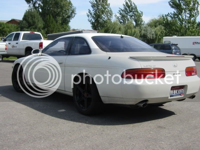

Sorry for the crappy quality pics. They usually have a cobra emblem in the center but I had my buddy that owns a vinyl shop cover them in black and do the red L emblems, cost me about 10 bucks. This is before the drop and roll but you get the idea.
Cheers
