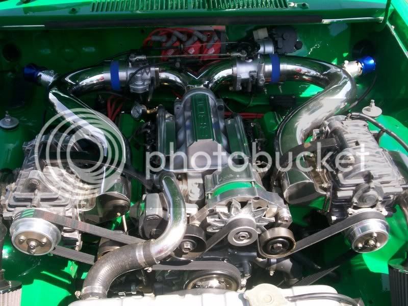

Sup bro... how about two SC14? I know a local Japanese Import sell them for like $95 each with about 50k miles on them. I wonder if those two charger mount in place of the alternator and ac compressor would be very cool.
Hello - There is a guy here in NZ that sells SC14's and one of his customers mounted two onto a 1UZ. Went really well. I would like to see photos. It may have been in a jetboat. Cheers
95$ each is a good price, but other then a small boost in power i dont think two would do a whole lot (400hp tops) i think some of the supercharger and turbo projects going on on this board are already a better way to go.
Sweet I haven't seen that setup yet on an 1uz-fe.... I like what I see if that setup can produce 400whp atleast??????
Ah I asked about that a few weeks back, regarding a 1uz and 2 eatons, and there was noone who had seen a twin roots charged engine,
Glad there's evidence of it working well. i just wonder if he's got belt slipage problems. and one stupid question regarding that set-up (holden V6 twin charge)
he's using after blower throttlevalves and 2 blow off valves to dump boost on colsed throttle,
does that mean the chargers can run without bleed (recirculation) valves?
and if so will it soak more power on cruise and idle? because that's when normaly the bleedvalve opens up and equalizes presure before and after the supercharger?

Having a solid pulley will mean the charger is constantly pushing air to the TB, thus the need for a BOV of some sort to vent it. The setup on my sprinter is still clutched, it it switched on via the autronic under certain load settings
