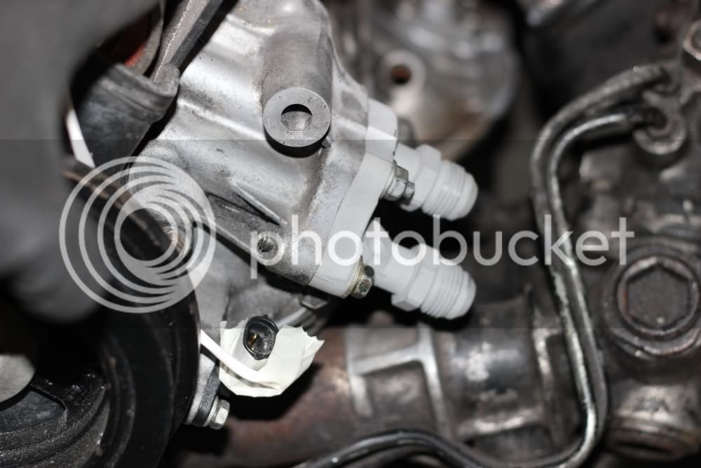

RedPhoenix New Member Messages 505 Location Palm Harbor, FL Feb 21, 2012 #1 For some reason I have no idea on which way the oil flows out of the oil pump. Is it the top fitting or the bottom fitting that has the flow OUT?
ash New Member Messages 407 Location qld Feb 22, 2012 #2 Bottom out... The oil pump Top IN to send oil to the main oil gallery up the centre of block Last edited: Feb 22, 2012
cribbj "Supra" Moderator Staff member Messages 4,790 Location Houston, TX Feb 22, 2012 #3 As Ash said, but graphically Attachments IMG_0840 (Medium).JPG 68.1 KB · Views: 53
