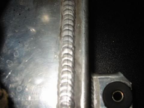

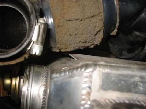

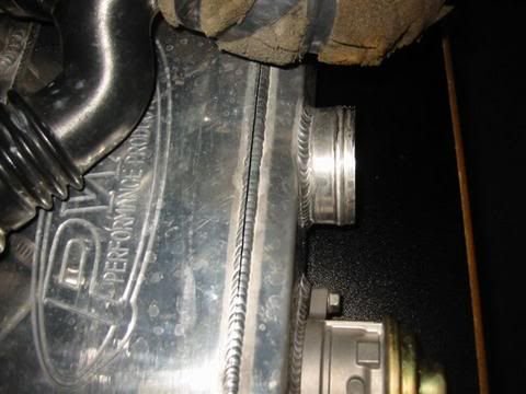

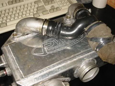

Some of PWR's "good work".
I don't recommend PWR...
I do recommend ARE.
