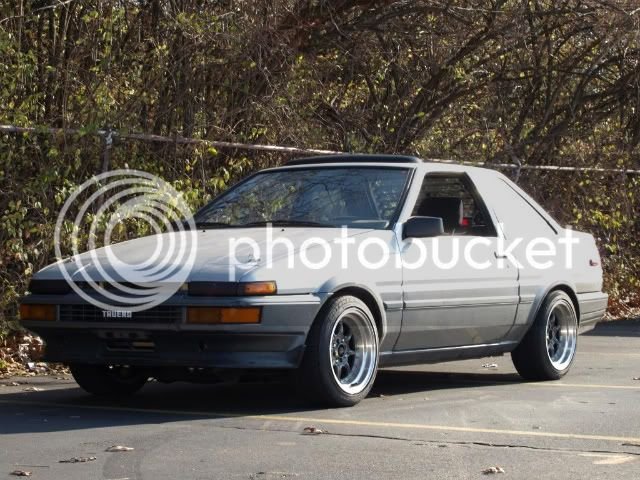

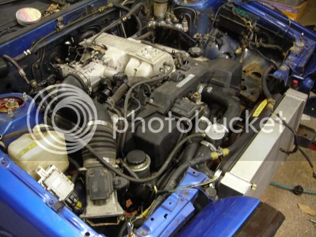

Car: 1987 Toyota Corolla AE86

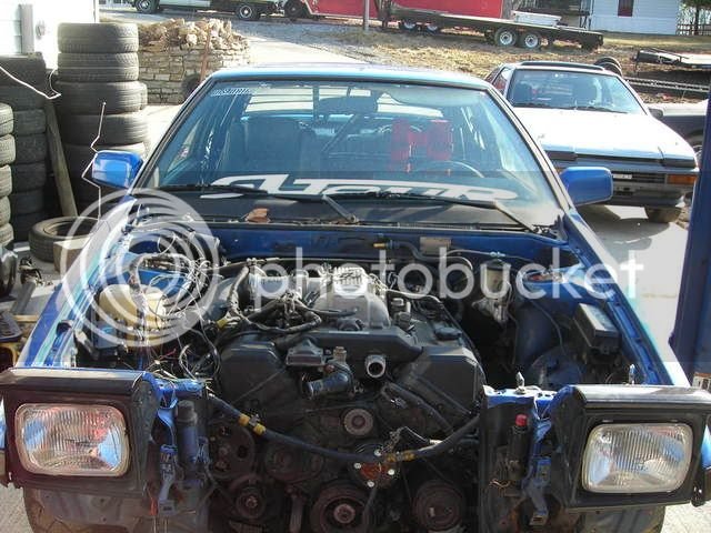

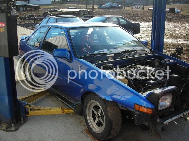

Engine: 1991 LS400
Transmission: 1985 Celica Supra W58
Details:
I DID NOT cut the firewall or trans tunnel to do this swap.
SC400 exhaust manifolds (must modify drivers side), and no-trac throttle body.

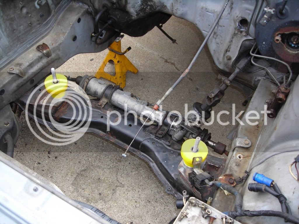

lowered front subframe 2 inches
custom one piece driveshaft and mounts
ae86 sr5 power steering lines are practically a direct fit.

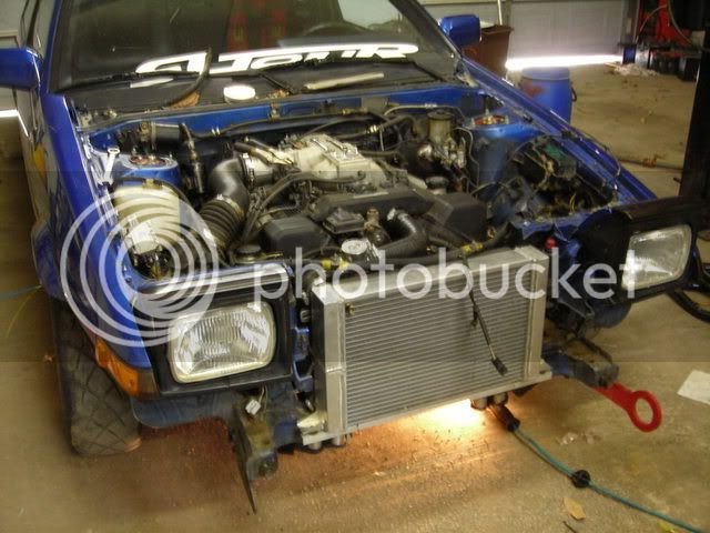

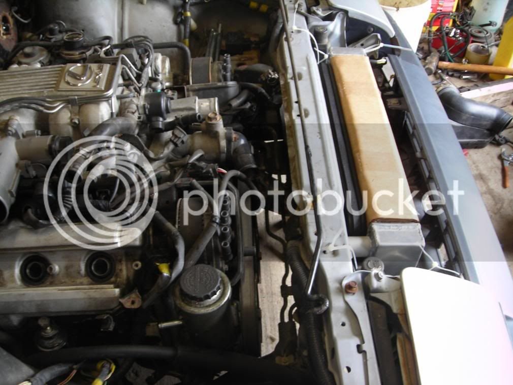

summit racing scirocco radiator mounted in front of core support w/electric fans
Howe racing hydraulic release bearing
EGR deleted
twin 2 1/4" pipes into a single 3" under diff with random off the shelf muffler.

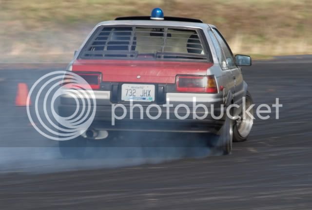

Some parking lot fun at a local drift practice:
