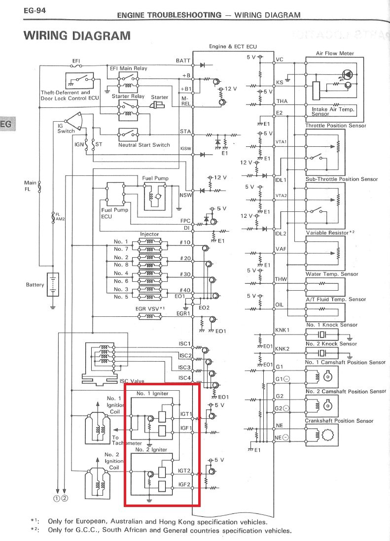

Just wanted to add since i've finally found my solution after years. I've done basically everything och has done and have the same problems.

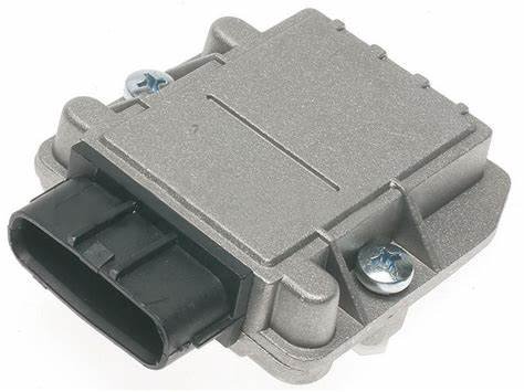

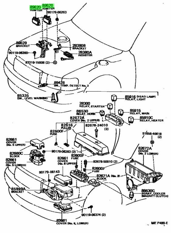

I recently swapped igniters with my mate and low and behold, CAR IS FIXED! I can finally go up a hill without flooring it
I've never heard anything about a partial igniter failure so thought I'd share my insight. I had no codes for them, but it appears partial failure is a thing, although it must be pretty rare if there's no posts about it. Hope this can help someone else out with their car
