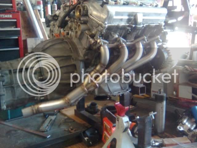

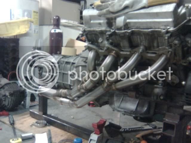

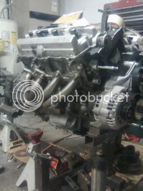

Looking good mate. Hydraulic throwout for the clutch i assume looking how tight it all is?
Justen, Thanks..... Yes sir, Hydraulic release assembly. Although there would be enough room just about the top secondary to use an external slave with a release fork but I'd rather not due to the heat heat rise from the header pipes. Yeah, they are stainlss and thus offer up great heat retension but still dont want to take any chances.

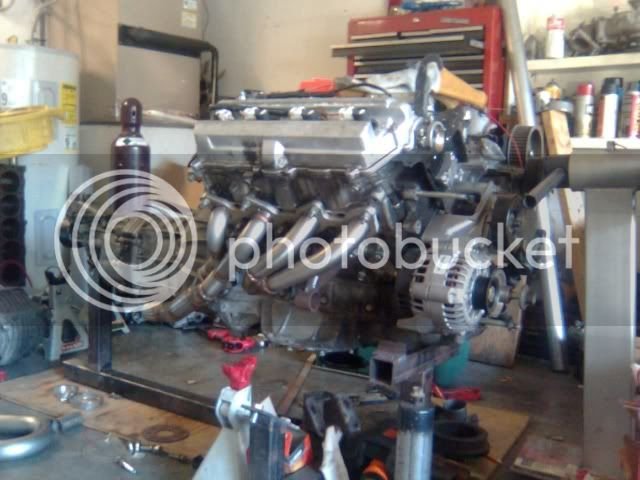

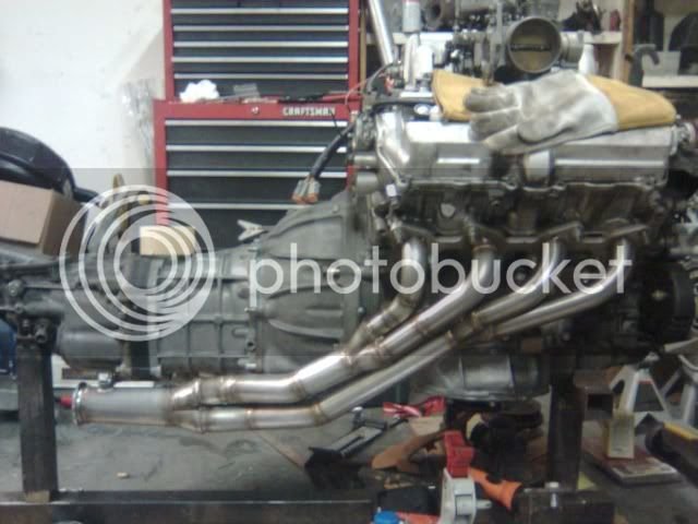

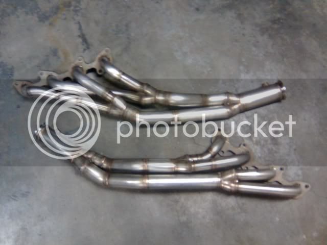

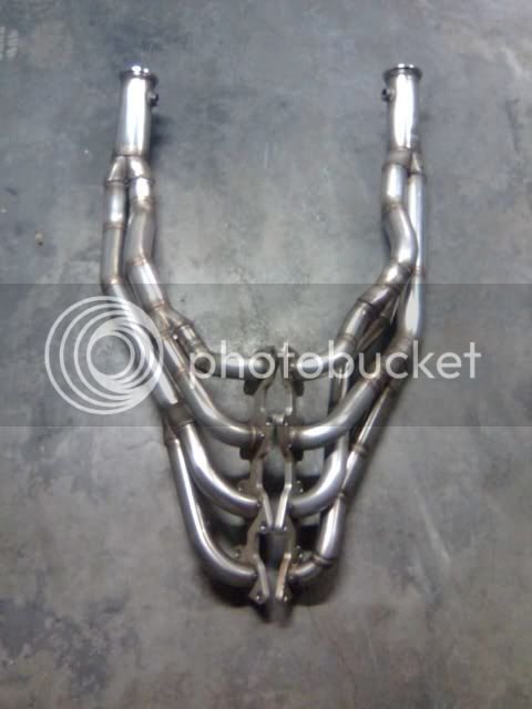

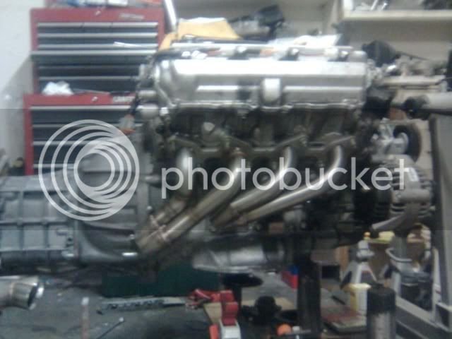

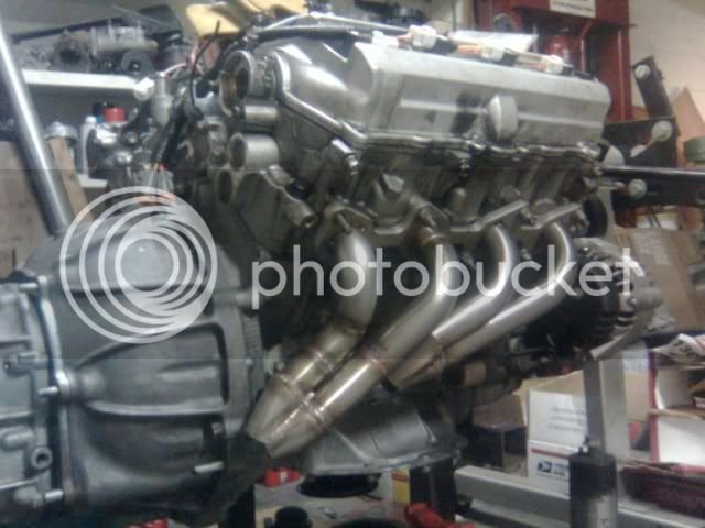

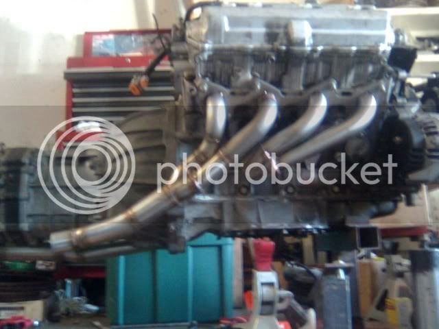

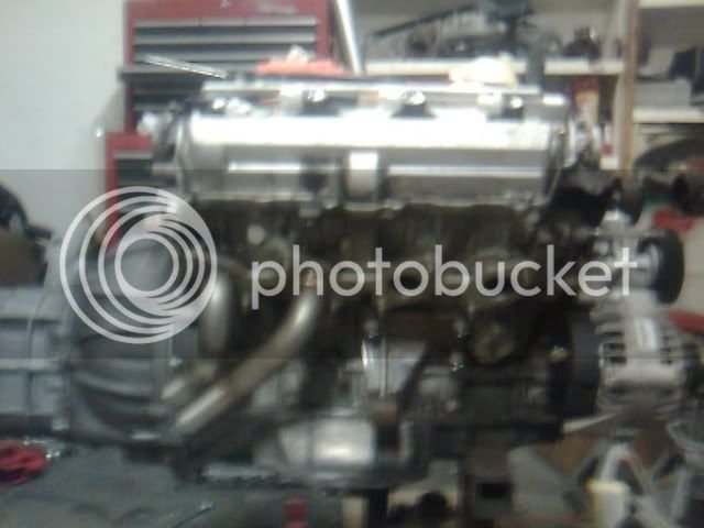

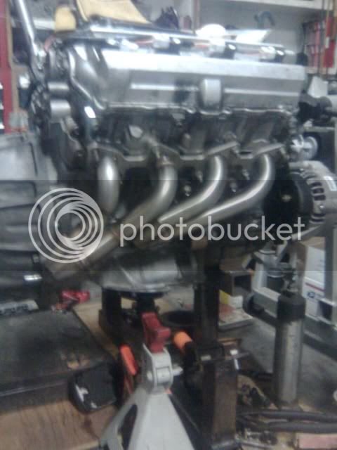

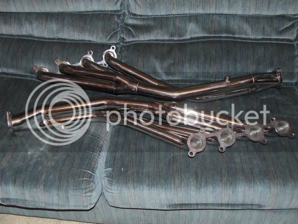

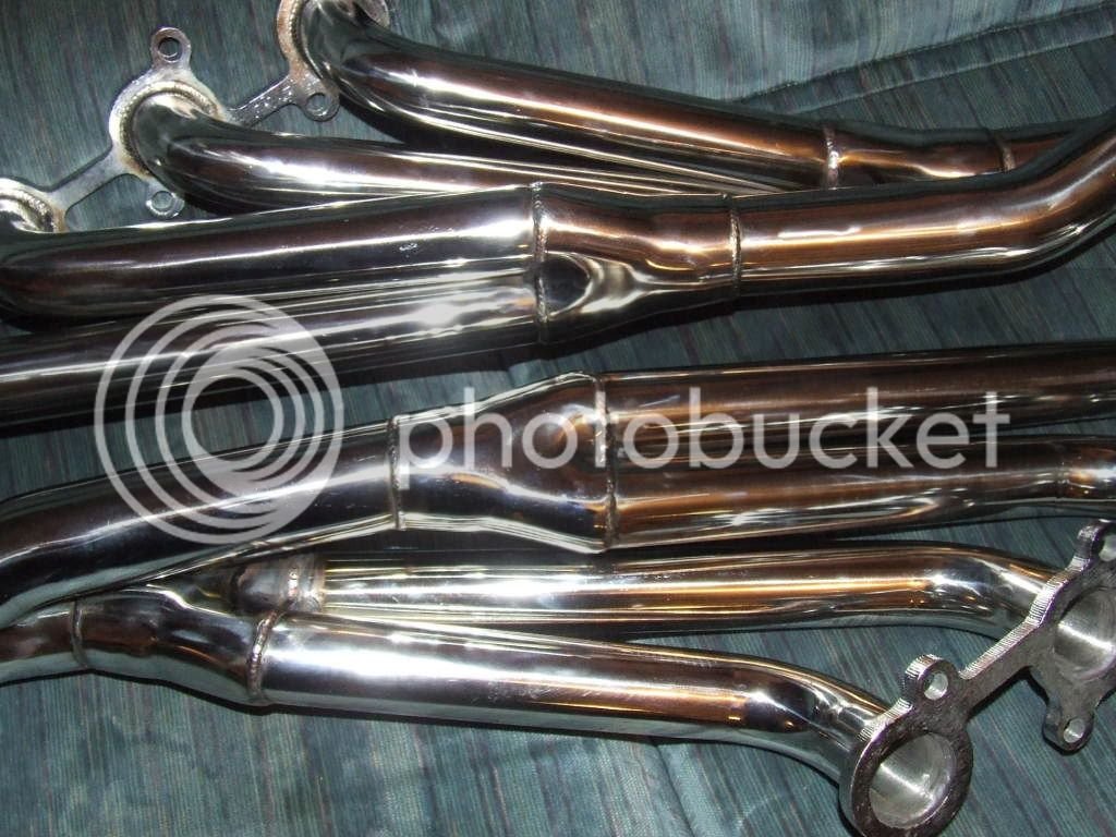

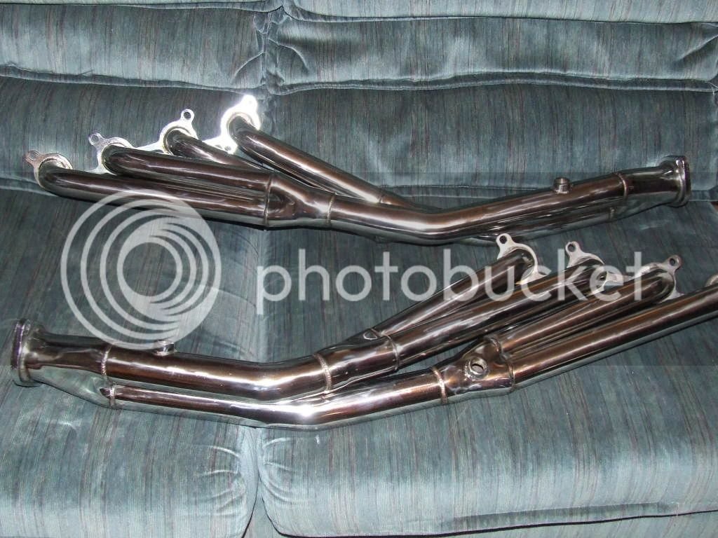

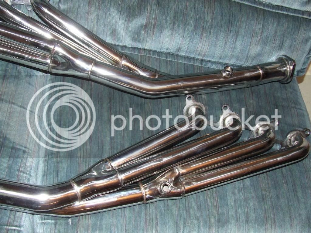

A small update.... This weekend, I finally got around to doing a bit of work on the Right (passanger) side header. Here are some pictures
Headers are Finished!!!!

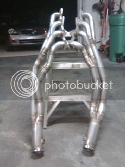

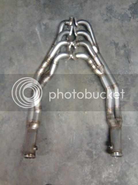

I finally finished the passanger (right) side header today and thus the set is complete now... Now it's time to put the engine and headers in the Supra...
Here are some picturs (enjoy)
Progression of the passanger (right) side header from where I left off....
Completed passanger (right) header.
Congratulations on finishing this part of your project...

Any plan to make some for our members?
Possibly.... If I do end up doing some for other, its just going to be on a one by one bases because of one not having the equipment nor time to handle a larger production run (so to speak)... I have actually been in contact with a couple of members about doing some one-offs for them.
I still just love your headers!
Those arnt to far from these Rush headers I bought. These have a 1.75 Primary feeding into 2" pipes feeding into a 2.5"
Of course they probally wouldnt fit your application but for the money they are a steal.
I'll tell ya, looking at the Rush headers now and mine, the Rush units might have actually worked......
As for the them being a steel, I dont think they are nearly as cheap as what it cost me to build mine as long as you dont add time into the equation....
