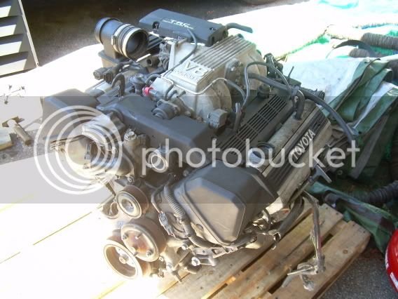

Lol this thread needs PICS! I'll let my pics speak for my progress so far
Not much happnin yet. I'm going x-member shopping this week hopefully. An AE86 xmember and R&P should help my cause alot 8)

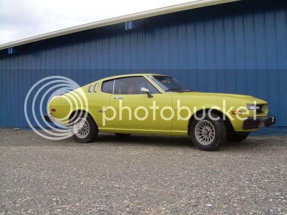

Stretch, its a 1977 RA29. The very last year on the 1st gen. They came out in 71 as a coupe, but the liftbacks like mine didnt get to North America untill 76. Good luck with your Gen4 project, it sounds like a lot of work, but that should be a real sleeper when its done!
I'm going to be using a MkIII Supra R154 5speed and MkI supra LSD rear end. Flywheel will be customed, I havent decided what route I'll aproach that from yet but i imagine it will just be a supra turbo fly modified for my UZ.... The thing I love most about this car is all this crazy ass stuff just about bolts in! I dont have to really cut or weld anything but a few brackets. I have all the racing suspention options of the AE86 crowd, combined with classic looks and V8 performance. I've spent a lot of time obsessing over toyota's but have never found a car as easily modded as this one! :D
