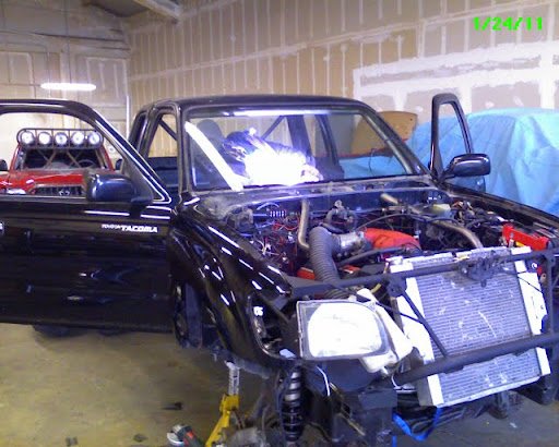

Not the best quality pictures but all I had with me was my cell phone. Making some major progress. We'll start on a front bumper next and finish the front off with a removable crossmember over the engine. It's amazing how fast we run through the tubing while we are adding more and more of it to the truck. The cab is also fully supported by the cage instead of just flexing up and down on top of the stock frame mounts.

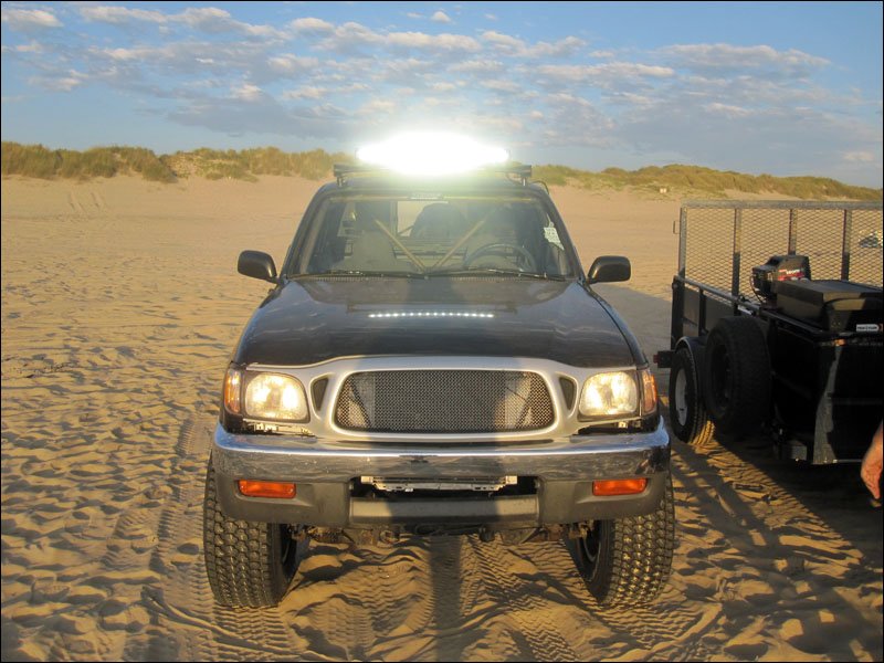

BTW, nice light bar.. is that going to be a high mount tail lamp?

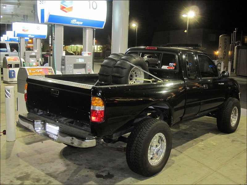

OH MAN THE 1UZ IS A BEAST! Sorry spf and others just been busy workin on all sorts of stuff and the last couple weeks have been actually using my truck for things I intended to use it for. :D I got all sorts of little things taken care of and I had to swap in another transfer case because a roll pin sheered in my old one causing me to lose the ability to shift into 4wd. SO I spent one weekend in the sand with my sand paddles which was a great learning experience. They worked GREAT and I would have been stuck many times in the sand if I didn't have them. They don't work as good as 4wd BUT with the V8 torque I would have buried my rear end so many times if I didn't have the paddles to push the truck forward. Plus once I was at speed they really offered some more traction. Last time I went out with 2wd and no paddles I didn't spend that much time on the sand because even aired down to 5psi I still didn't have nearly as much traction as I wanted.
NOW I have my spare transfer case installed and 4wd is back in action. WHAT a huge difference! I went out last weekend without the paddles because I knew I wouldn't need them. I just aired down to 5psi in the back and 8 in the front and I had all the traction I needed. It was so awesome with 4wd and the V8 engine under the hood. There was no way I was getting stuck and I didn't even have to use 4LO like I had to with the 3rz 4cyl engine! I just used 1st and 2nd gear which allows me to torque around from a stand still to 60mph at full rev in 2nd. I hardly had to shift at all which is really nice offroad. I remember with the 4cyl engine I had to use 4LO and shift a lot to get the truck moving around at a good pace revving the crap out of the engine. Now I hardly have to use the gas pedal at all and its extremely fast.

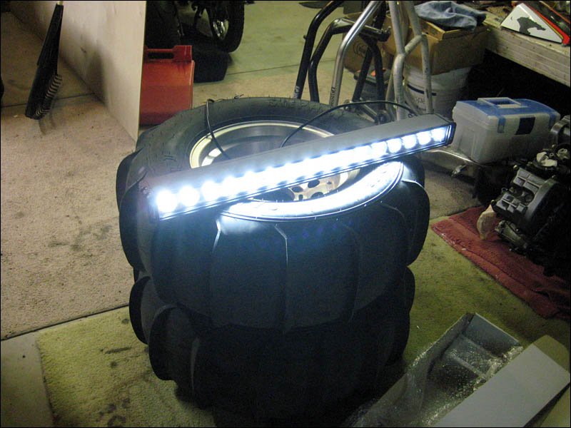

I just recently went through the trouble of mounting the light bar up top as well. I had to make a full custom rack and brackets for it so I spent a good days worth of labor on it but it's perfect. Light will never be a problem again. :) I'll throw up some pictures soon! Plus I have pictures of a smaller lightbar that a friend of mine just bought from the same company for his fishing boat.
