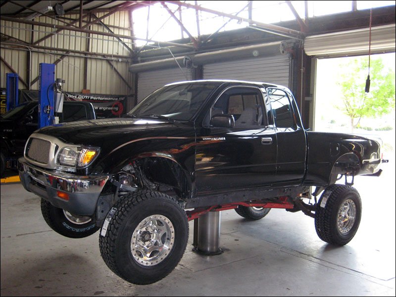

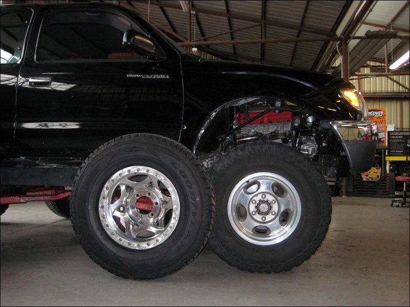

Engine runs great - truck is rediculously fast and rollcage is top priority now. I got the wheels I've always wanted and the all terrains ride so much better then the muds - the ride is much better. I'm also am building a full floating Ford 9" rear end which will complete the rear suspension that was designed for it. The front suspension and spindles are being built and I'm hoping I'll have time to tie it all together before the end of the year. The trick will be keeping it looking street legal. :)
18" travel in the rear. Deavers hung on Total Chaos shackles, custom mounts of course. Not sure about what I'll end up with up front. Definitely keeping the 4wd and I'm sure I'll be making some custom axles to get longer travel up there. I'm shooting for 16-18". Should be fun!
Just picked this up last week. I'll be trussing the thing from left to right and stuffing it with 35 spline axles. I have hubs and Wilwood brakes I have to pick up as well. My rear suspension was designed with this rear end in mind so I can't wait to actually have this underneath the truck!

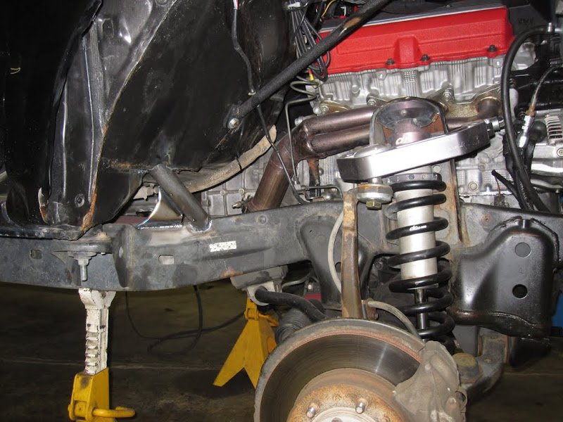

He's building my front suspension however I want. I don't think I need super travel like he has on the race truck but I want at least 17". Then we'll build a new steering system to handle it all just like his race truck. DOM for the roll cage will be in next week. All I have to pay for is the steel and heims so I'm hoping I can afford to keep the ball rolling on this build. Fiberglass is the only thing that's going to be hard to pay for right now... since it costs some $ for the fasteners and stuff to secure it as well. I will have to find a used set of bypass shocks too. Hopefully be done by the winter/spring.

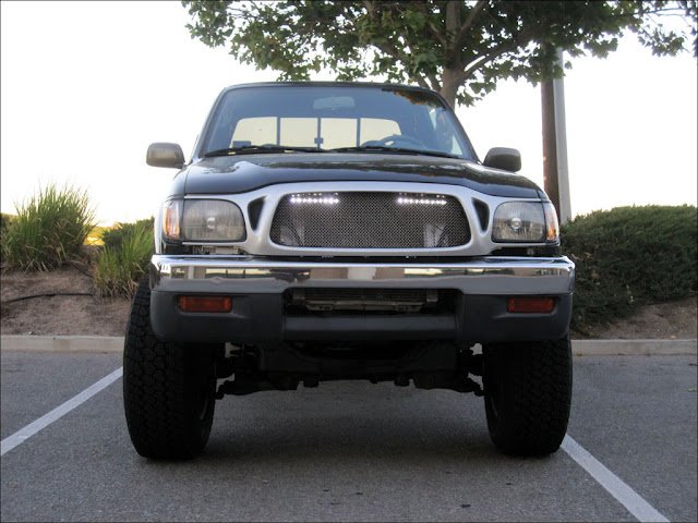

Biggest update this week, grabbed some PIAA lights of the shelf and threw them on the front of the truck. I hate it when people are driving slow and act like you aren't there. These little daytime lights will get their attention I think. They are a quick fix for now until I get my bumpers made and put some real lights on them. I was going to put them right under the headlights as you can see where there is plastic missing from under the drivers side one... but that would have taken forever to make a bracket for them and they would be moved eventually anyway.

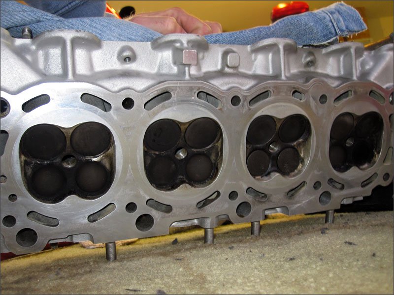

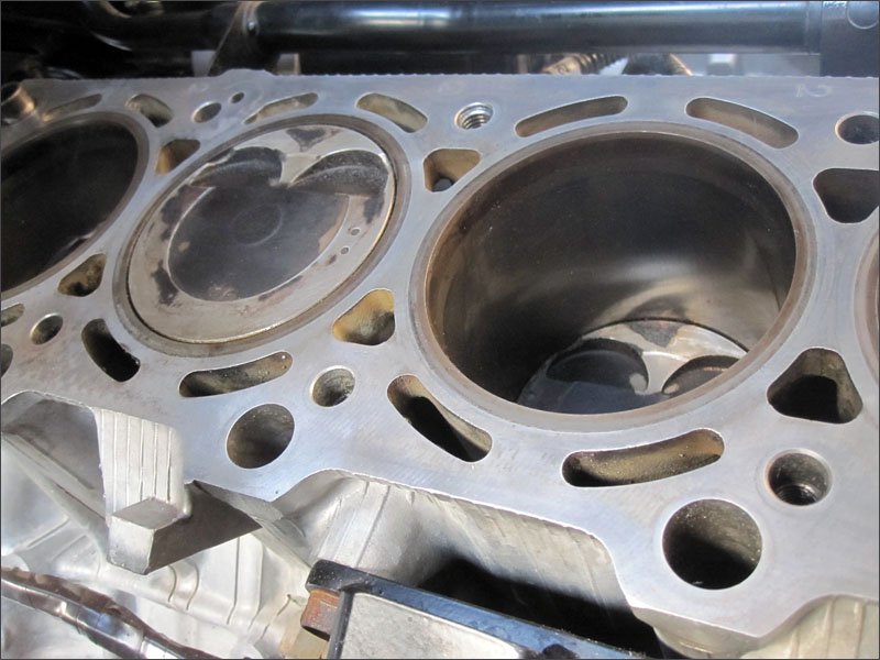

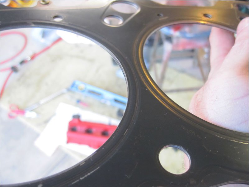

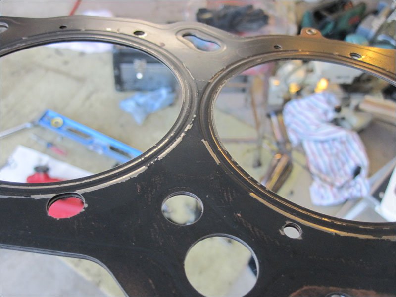

Ok here is an interesting topic. I didn't torque down my ARP studs enough to get a good clamp on the Cometic headgaskets. I probably drove it about 1,000 miles before I noticed the engine was running rough so I quickly removed the spark plugs and found the two middle passenger side cylinders were wet. I know I didn't tighten them quite as much as people typically do with the ARP/Cometic combo. Nonetheless the middle head stud had pulled up out of the block causing the head to lift and leak fluid into the cylinders. I put a heli-coil into the block and I'm ready to put the head back on. Here is what I have right now - engine apart and some low miles Cometic gaskets. I'm not running boost and the heads have been ported polished aggressively. The heads weren't milled down enough to bump up the compression noticeably.
I've read of many people re-using these gaskets with good results. And have read of people tightening down the torque a bit more and taking care of leaks. Should I spray with copper sealer and re-use? I can remove my heads out of my truck in about 1.5 hr and put them back in about 2. So I'm considering torquing down on them to give them another go.
I'm suspicious of the water passage in the middle. The edge of the passageway is awfully close to the bead roll around the edge of the cylinders. This is just one side of my engine. The other side is doing just fine but if I re-use these I'll go ahead and increase the torque on the other cylinder bank as well.

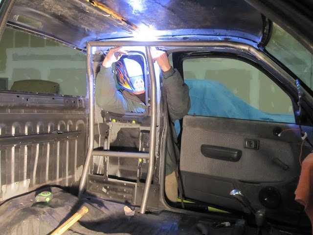

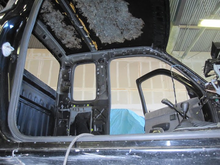

Long time no post. Been getting ready for the rollcage build. Pulled the truck in, stripped it in a flash and now it's down to business. My fabricator dude and I making some really fast progress and it's looking incredible. I've been waiting for a long long time for this. The cage is going to be in the walls of the body and I'll be insulating it all when it's done so it will be cozy. Hey RunnyR - We'll be going from front to back on this thing (interior cage) and time allowing, bumpers too. My friend knows how much time I've put into this truck so he's doing his best on the rollcage to compliment the rest. He doesn't even have a mig welder in his shop so this whole thing will be tig all the way. More to come.

Interesting that you had a head stud pull out on an N/A engine. Was it the stock 10mm, or an ARP in the stock size, or a 7/16"?

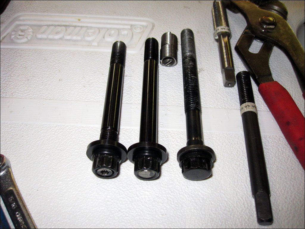

Hey well the cage is like molding clay to me. Nice to just turn off the phone and go for it. The ARP stud pulled out and now David sells an "updated" stud length that goes in below that center cam gear. I went for broke and threw in the double heli-coil! I don't recommend anyone do this though just so you all know. But I did it very very carefully! :) It's NEVER pulling out now.
Wrap your brain around this picture below. Talk about nervous... slap in a couple heli-coils one on top of the other and feel how that stud torques down inside that! I had to take a shot of whiskey before I did it.
But I kept telling myself I have an extra engine 5 feet away from me in the garage so no worries! :D
Stock size ARP. The old measurement for the studs Lextreme used to sell were way too short and I was told that there was nothing to worry about. Well there was and I paid the price. Now the ones he sells are longer for this very reason so there's nothing to worry about unless you were sold the original length stud that was "supposed" to be ok.
Here is another picture of my truck in the worx. Having lots of fun working on this cage stuff. Now I can mount the seats on the crossbars instead of the flimsy floor and also the stereo stuff will be resting on the cage as well. I'm really looking forward to having a much stiffer chassis and better handling as well.
