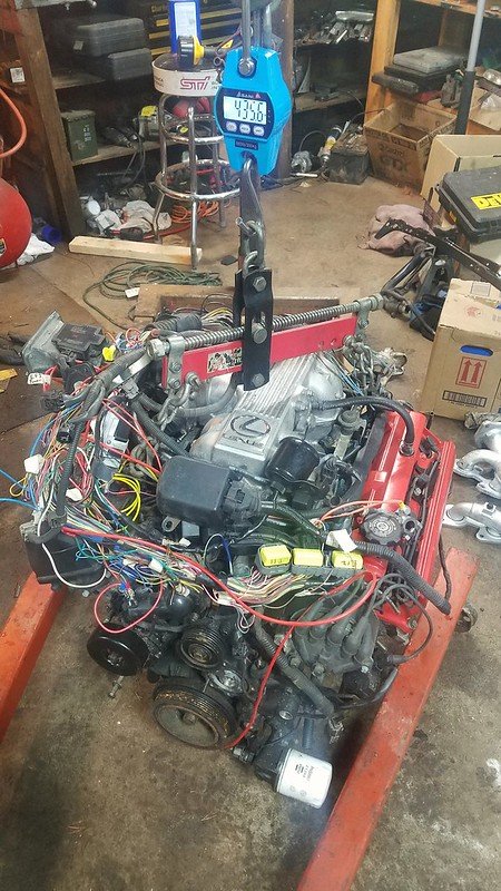

This one is from a '94 SC400. Obviously with wiring harness, ignitors, MAF, flex plate, oil pan. No accessories or exhaust manifolds.
2021-02-16_04-54-04 by Numbchux, on Flickr
