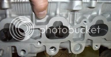

What's wrong with the 2uz-fe port design? Compare a STOCK 2uz-fe intake port....
attachment.php
VS. a PORTED 2jz intake port...
Eric
Yeah that guy has quite a meathook there. : ). You can port out the 1uz head to a point it appears, but the port design was meant mroe for fuel economy that for performance. On the other hand, the 2uz ports are very similar in appearance to the 2jz ports.
FWIW, I know the 2uz-fe's that are making 650rwhp N/A are doing it with stock 2uz ports. The ports seem to flow very well, and don't suffer the same angled offset issues that that plagues the 2jz-gte. I personally feel that if you're in the pursuit of HP, the 2uz heads are the way to go.
