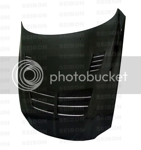

I guess it's a little late but I know NRG makes carbon lockable pins that would have a smaller footprint. Frankly I like those aerotech? hood pins, and thought about them for mine to solve my hood lock mechanism issue but never tried. Nice hood tho Steve, I am picking up an SC400 hopefully this December, I have been drooling over this Seibon TSII vented hood for the SC:
Only down side to me is the $700 price tag =(

I almost bought that Seibon hood, but I got a good deal on this VIS hood so I went for it. If you'll buy the SC4, then you're more than welcome to join the SC4 family. Go for black? We'll appreciate if you'll go with black SC. :D Boost it, right?
