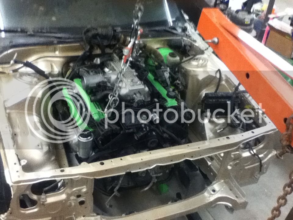

Always liked toyotas and V8's so i decided to put a 1UZ into my 89' cressida.
89' cressida

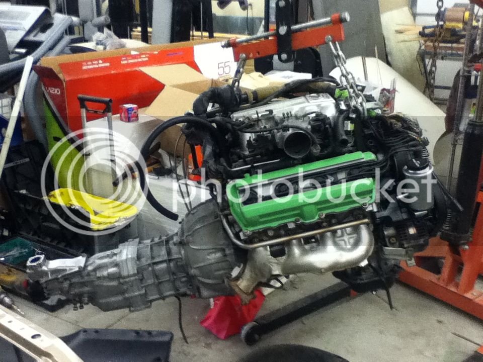

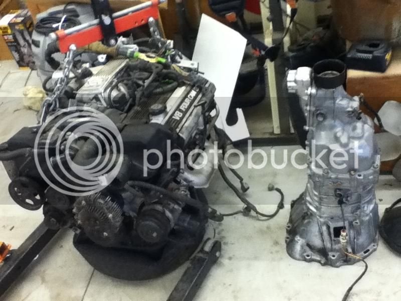

Pulled a 93 UZ from the yard along with a w58
Pulled the 7m out and cleaned up the engine bay.
Cleaned up the engine, replaced belts, seals etc...

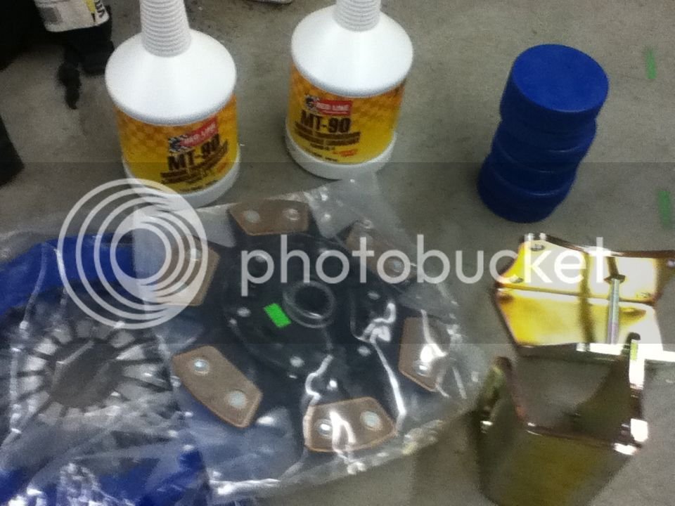

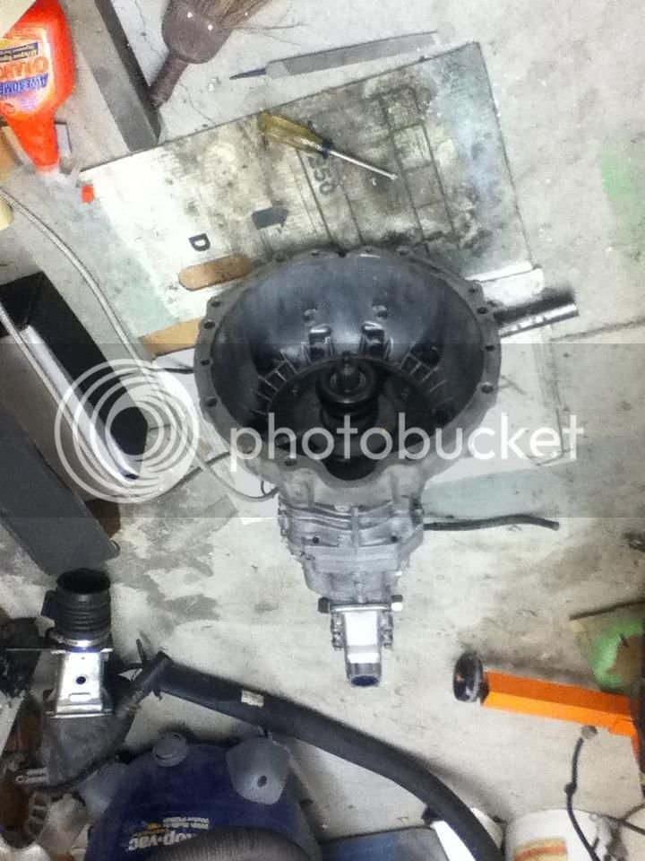

put together my 5 speed adapter from toyotaV8.com and other goodies.

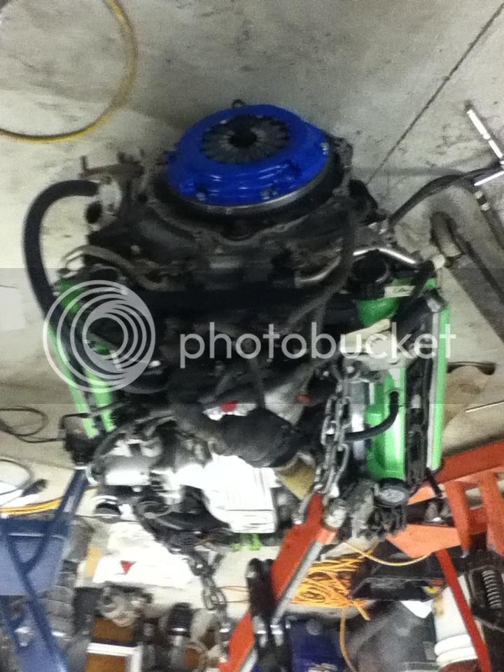

Installed the clutch mated the trans and put it in the car.

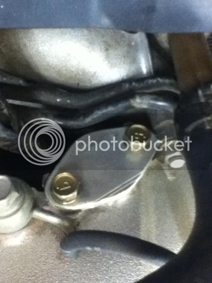

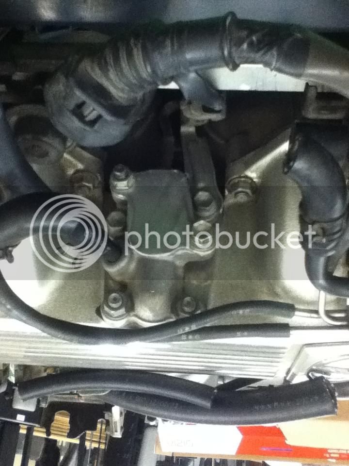

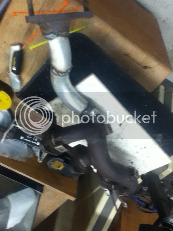

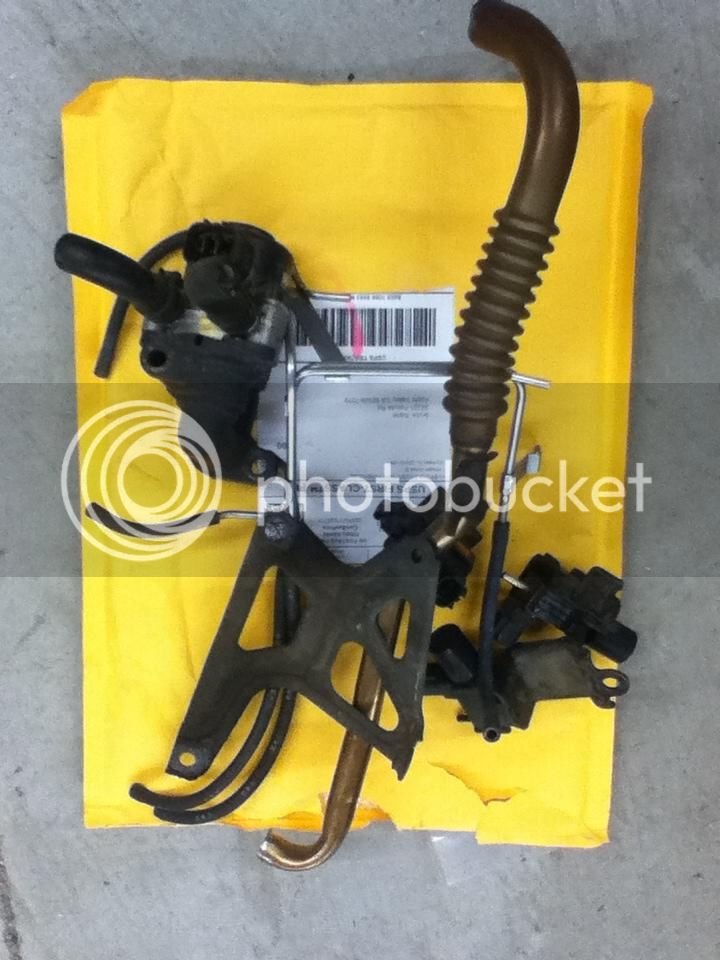

Did and EGR delete, fired out the wiring and the exhaust clearance.
Put my 5speed stuff together, along with re-assembling everything
