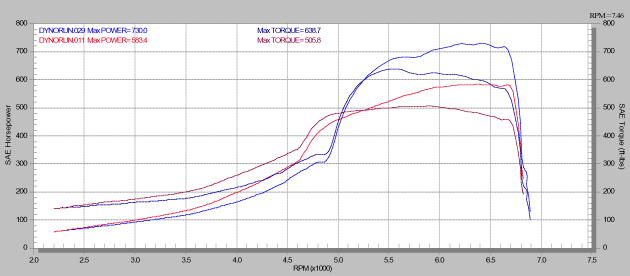

Here is a GT42 dyno on a 3.0 liter Supra (24 psi). The graph below represented a 3.0 liter. I am not sure how would a 4.7 liter would look like, but I am sure it will alot sooner then 3.0.

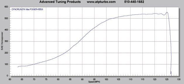

Here is something very similar to the 1uzfe dyno. This is a GT35R in a MR2 (2.0 liter at 24 psi)
The last picture is the GT3071 in a STi (2.5 liter)

Here is a nice example of GT30R on a 2.0 liter Honda at 26 psi
ohh man, nothing below 4700RPM with the supra... BOOOOOOOOOOOOORING!!!
