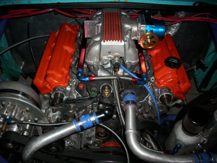

After four months waiting for ARP head studs and Cometic head gaskets to arrive in Bangkok, the motor is finally going back together.
1UZ%20Reassembled%2008%202010.jpgA photo from yesterday taken by my engine guy, Art, at Voodoo Racing in Pattaya. It's coming back together! The cams still need degreeing, and other details . . . but the project is coming back to life.
It Started (I think)!
I received this e-mail from my shop guy, Art, in Pattaya:
"I started your truck today. No leaks any where. I mean not air leak, and no fluids leaks. Started right up on the first try. Starts very easy. Idle nice, and respond nice. More later...."

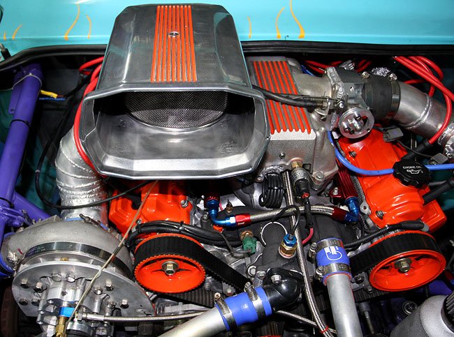

I know I'm always a little shocked whenever a static lump of ally and steel that I've been shedding blood & sweat over for years finally comes to life.
I had a long phone conversation with my shop guy . . . it all sounds like it is ready to tune. I am now waiting for a dyno session confirmation for September 24th. Lots to do then: Set up main map, single NOS nozzle fuel enrichment map, and duel NOS nozzle fuel enrichment (dry NOS system).

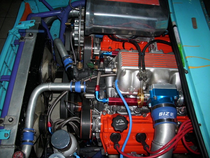

Called up my engine guy last night and he started the beast so I could listen over the phone: TOTAL AUDIO DISTORTION. After the call, I had him let it idle for 10 minutes (jacked up and in gear) to get the motor and running gear up to temperature and to check to see if the fans all worked and nothing got too hot. Check. Still waiting on the dyno appointment confirmation.
Good News
. . . . so, I will go to the shop this Saturday, Sept. 25th to make sure everything on my race truck is perfect before we dyno it - and will take photos and some movie clips of the motor running . . . to post here. I have made a booking for the following week for the full dyno pull. I may (fingers crossed) be on the drag strip by the following week-end. These projects sure take longer than you anticipate!
