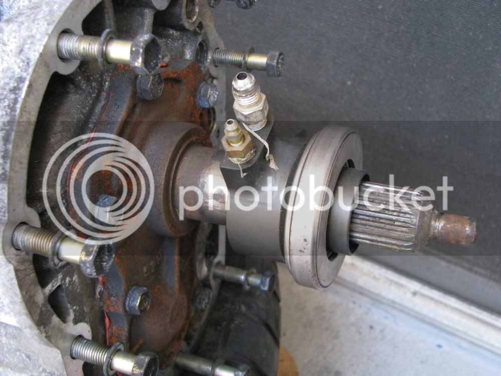

What style fingers are on that pressure plate?
If they are straight (like most are), the bearing on the howe unit is not suitable as its made for curved fingers.
The bearing should be a cone or slanted shape.
The howe bearing will work, but there is a good chance itll fail prematurely.
If you look in the picture in post #11 you can see that the bearing is a rounded nose bearing. It is the same bearing that Im running on mine and it also happenes to be an actual toyota bearing. I dont remember what model Toyota, but I do know that the part number of the bearing that I have and matt has crosses into a OEM Toyota number. It is suited for a flat finger diaphram pressure plate.
