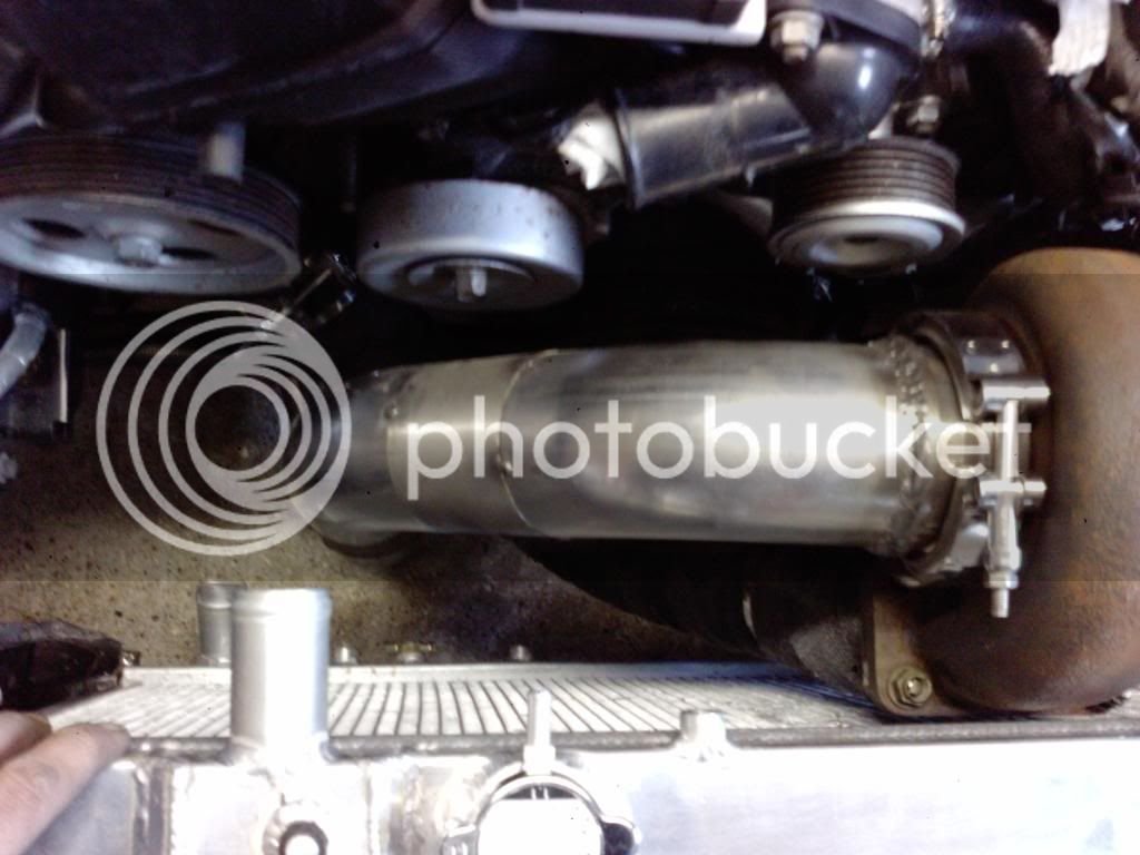

dam i have just been out to try and mount my atl like that only to find out theres no room, so it looks like i will have to mount it next to the PS/pump and off set it and then weld a 2nd pully on the PS/pully so i can then run a 2nd belt to that hhhmmm have to see how it go's
as you can see in the pic, theres just no room.

It may only be XJ-S Jaguars that had the reverse mounted alternator.
Not sure about the Double Sixes.
