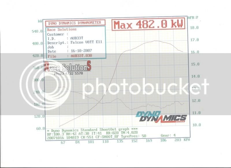

Yep I have 1" 1/4 [steam pipe] on a 330w V8 Ford with over 650 r.w.h.p at the wheels..
Std shorty headers are 1" 1/2, with 1 5/8 used on hi performance N/A applications..
At 18 Lb and at 6400 rpm it has 24Lb back pressure and climbs from there, on a pushrod engine rpm much higher isn't required.. .. Maybe due to twin .63 A.R turbine housings..
Turbo's also use pressure to make power as well .. BUT you have to keep track of back pressure !! On a street engine 2 to 1 back pressure is acceptable..
In most cases 8 to 10Lb is sufficient...
