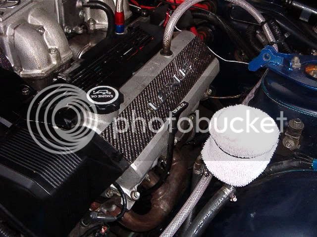

Engine is standard apart from
link computer
open air inlet

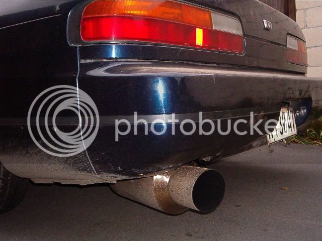

and a 2inch y pipe mergeing into a 3inch exhaust which is fairly open
