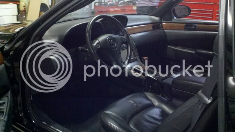

Just want tp give all of you an update. As I mentioned recently, I needed to get the boost controller sorted out, along with the Innovate Air/Fuel gauge reading the mix coming from the wideband, fix the gated shifter auto shift lock issue, and button up the car. This is all completed now.
The Innovate is a pain...great unit, accurate, quality, but, the LC1 is a bit painful and very complex to set up and program. The wideband has to frequently be "free air" calibrated because any anomaly in the wiring resets it. It also cannot share power and ground with other devices because of it's stringent tolerances for voltage. But it is working well now...

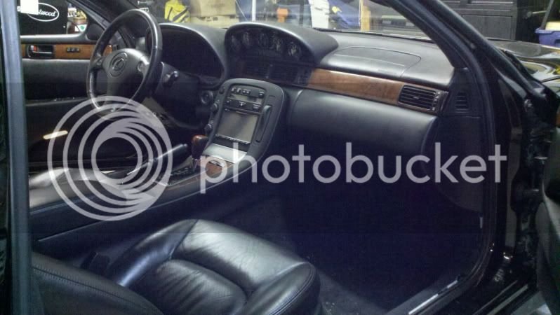

My interior is mostly buttoned up now, and that makes my car feel much more complete. No more tons of wires hanging out everywhere. You can see from the pics that it now looks like a car again...

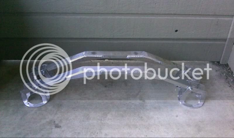

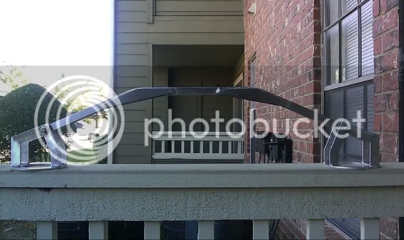

Installed the rear mount STB from Scooter!
Guys, the rear mount STB is is installed on my car. I did notice what seems to be more stability when driving it. I like it quite a bit, and I am happy I bought it. I believe it is worth buying and installing on the SC!
Ryan
