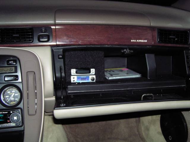

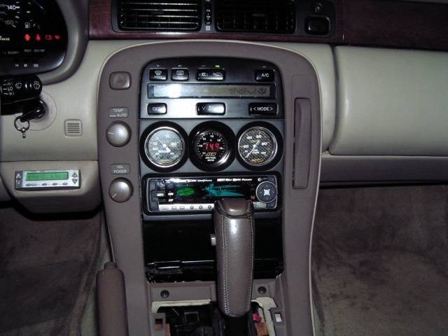

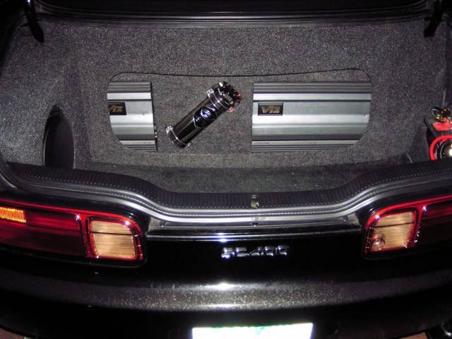

OK Gang, here are a few more pics...They do not do the car justice, but they give you an idea...
Custom Gauge Pod and EDFC Pod
Custom Glove Box Pod
Revised trunk

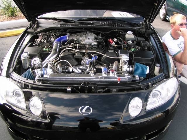

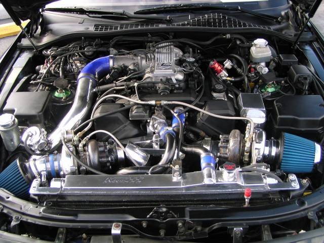

Updated pics of the engine bay from the show:
Ryan:thumbup: :D
The twin turbos GT35 inside the engine bay look good indeed. However, if I only have 1 choice, I'd prefer the twin turbos D35 standing right in front of the engine bay instead. :684:
That's QUAD D35's, Steve...:Eyecrazy: :hypnotized:
Ryan
Yes, they sure are and they share the same characteristics of the GT35s. If you run them hard, you may burn them and the oil will leak. :tongue2: Given that fact, they'll need proper cooling down period between each run. The only difference is they might disappear without your consent, while your GT35s will still be there.
