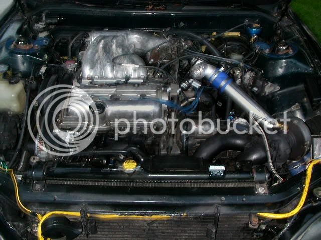

Here's high-temp ceramic black on a home kit. MCE's first attempt at powdercoating... Looks good!

...wait.. toysrme.. you said ceramic coating - did you apply that yourself? How hot did you cure it before placing it in service?
Yes, done at the house in the normal oven with the merge/up pipes done broken down. It's been awhile, but the best he can remember is 425f for a 1/2 hour. You'll need to check with the powder on that. The more I remember back to it, the more I think it was just 1000*f powder & not ceramic powder.
At any rate, durability hasn't been an issue. A near daily driven car for 9 months & it seems fine when we took it all off last month starting a tear down.
