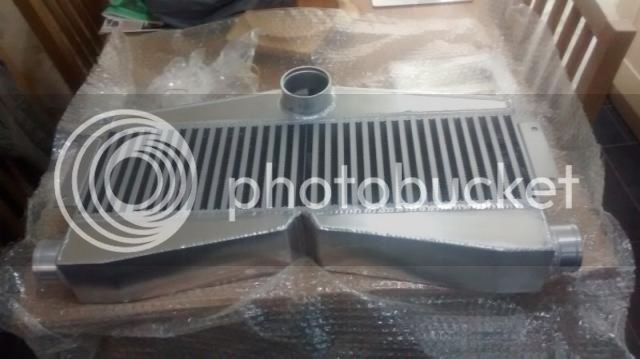

I was thinking of just adding some ARP bolts and thicker Cometic gaskets. Fuel in the UK isn't brilliant, but is at least consistent. I am thinking of fabricating a setup similar to the Jaguar XJR, but using a particularly lovely air/air intercooler I just won on Ebay for the princely sum of £41.
