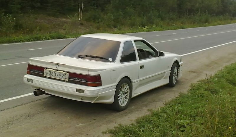

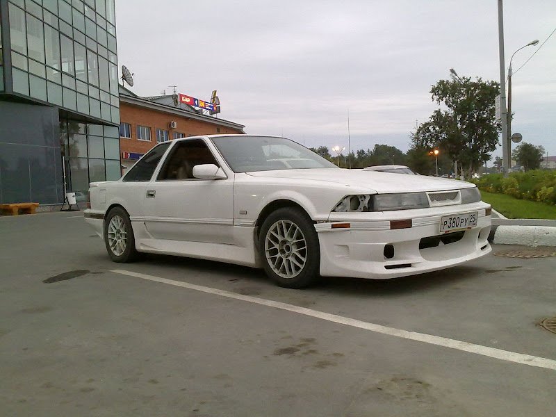

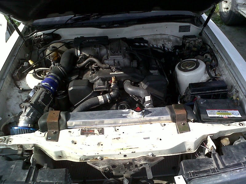

Ok, long time awaited update:
Just today swap has been roughly completed.
Project details updates: UZS131 engine with UZZ30 sump.
Crossmember is pre-88, not processed, the only cut - are the mounts walls to get ~420mm clearance for sump.
Square rubber mounts.
Stock UZS131 auto (and I will have to find out how to fit oil dipstick in there).
I can definetely say that the bonnet will hit the top of intake manifold. (btw UZA70 which is building in Vlad has the same issue with the bonnet).
