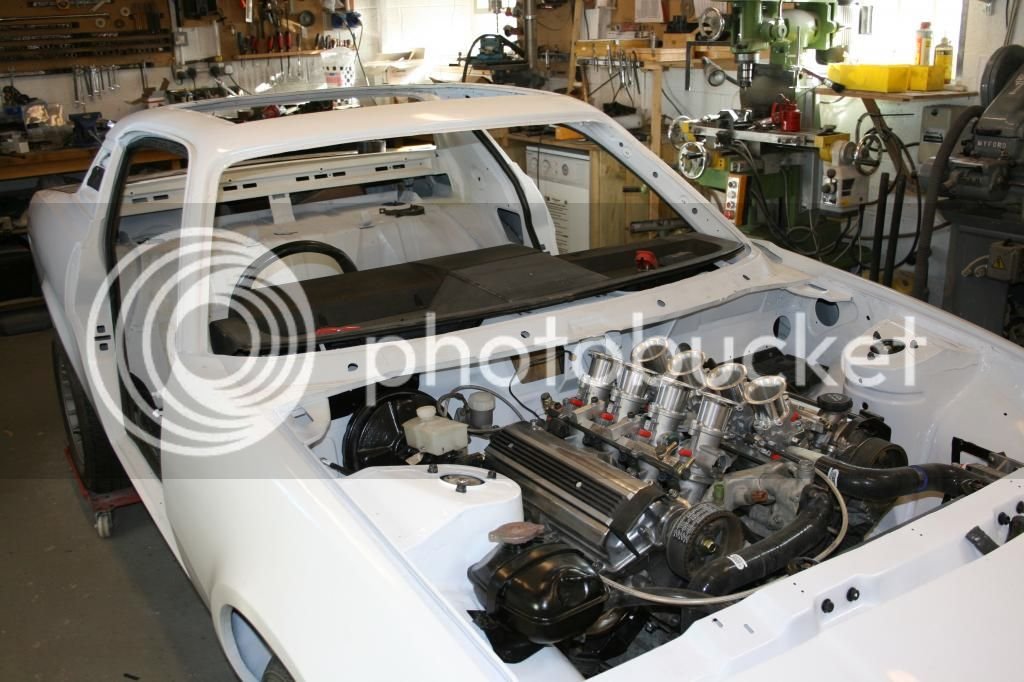

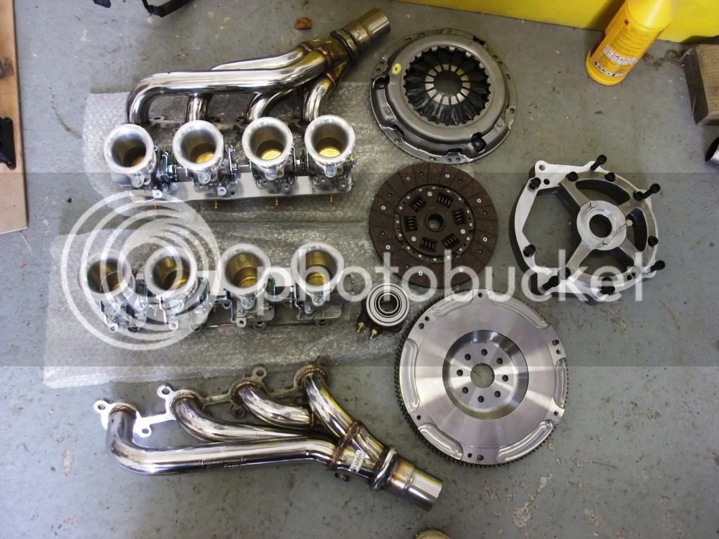

Welcome. I have nearly completed a 1UZ into TR7, it should be finished around Christmas (the engine/gearbox anyway). You definitely want to try and source a rear sump, it can be done without but it is a LOT more work. Mine came from a Soarer, I bought a complete car, ran it for a week to make sure the motor was good, then scrapped what I didn't need. The rear sump 1UZ fits better than either the 4 or 8 cylinder original motors and looks like it was designed for the car!
