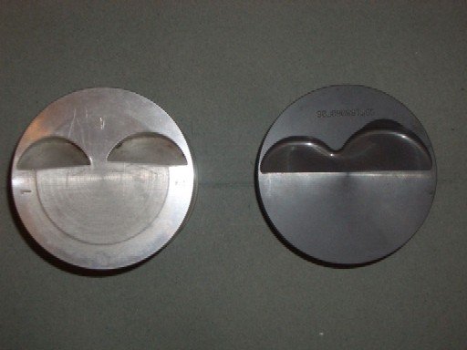

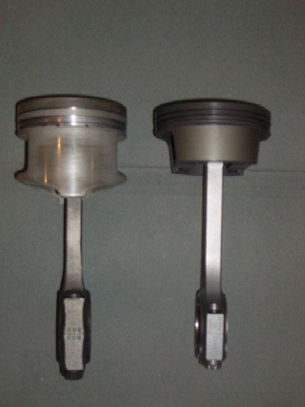

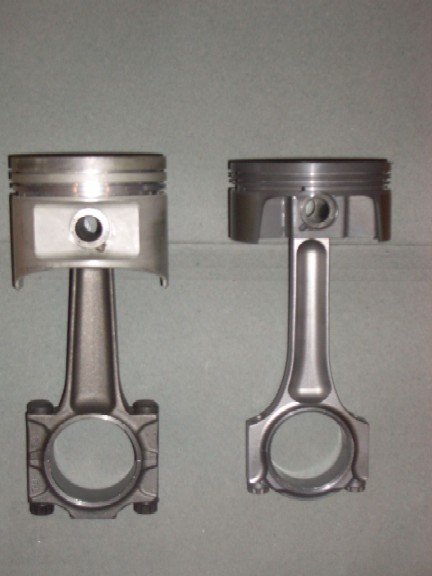

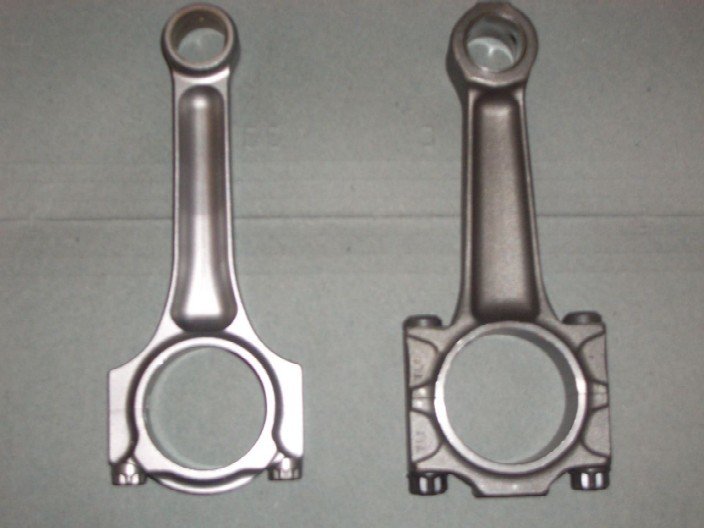

Hi to all I posted this idea some months back and I have now bought the pistons and the rods but it is for my Porsche V8 as I decided to drop the Lexus motor and keep my car authentic. The Honda style Chevy rods are also 48mm or 1.888". My rods and pistons are Nascar derived. My capacity went from 4.7 liters to 5.7 liters, the motor was bored and stroked.rod_comparison.jpg
The last photo really sets out well how you achieve this extra stroke, BTW the rod to stroke ratio in this engine is still a repectable 1.84 to 1. There is pistons available that have an even higher compression height. On ebay you can buy these Honda Rods but no shorter than 6 inch second hand, they can have the right width, i.e 0.903" but there is many different widths so becareful.
A custom crank (billet) will cost between 2 to 3k not 1k as somebody eluded to and Mahle have the correct coating to work with the MMC walls of the 3 uz. They also make custom pistons that are the finest in the world, superlight and strong, remember when it comes to piston design, when did Arias or JE or the like win an F1 race. Accralite or perfect bore make excellent pistons but not a coating to work with the MMC bore, with a stardard steel bore all pistons will work. As to the material I prefer 4032 for these short skirt style pistons as you can run a really tight clearance and keep the piston stable.
Cheers Greg
