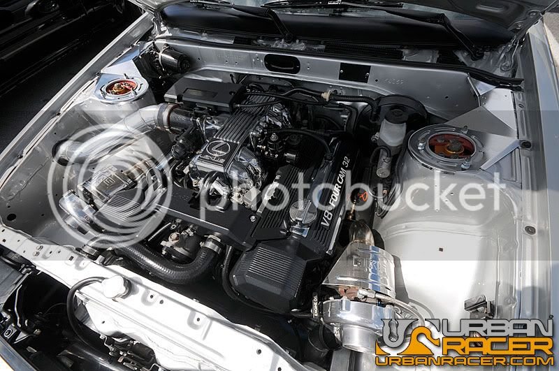

No dyno numbers yet but planning on dynoing soon and running her down the 1/4 mile by next year. Here are the specs:
Stock LS400 engine
Stock LS400 Auto Trans
Custom turbo manifolds
Twin GT2835R's HKS Turbos
Twin Tial 38mm wastegates
Twin Tial 50mm BOV's
Aeromotive FPR
Stock Injectors
Haltech Sport 1000 ecu
Lexus Stock Ecu for auto trans
Ford Mustang 8.8 fully built rear end.
Hope you guys like it, any questions feel free to email me at [email protected]

Thats clean man! Any tips on keeping all the under hood hoses and wiring looking so neat and tidy, thats one of my only turn offs from modern V8s (especially the Japanese variety for some reason).
lextreme- Thank u sir, i know I need that sticker ASAP:D. Shooting for a photoshoot pretty soon.
Thanks Cribbj and skatony. Trying to hide wires is a bit of a PITA but with patience alot can be hidden.

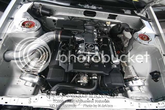

Cyberdiamond- The rear housing I believe are .82, 3 inch 4 bolt flange. these are the turbos that come from the HKS twin turbo kit for the 2jzgte. Ill double check for u tho. Havent had the time to dtno her yet but as soon as I do I will let u guys know.
Anodyne- Thanks bro, as of now the motor is bone stock, wanting to see what it can handle b4 building it. Theres been a couple of guys here in this forum who have gotten great numbers with a stock engine.
