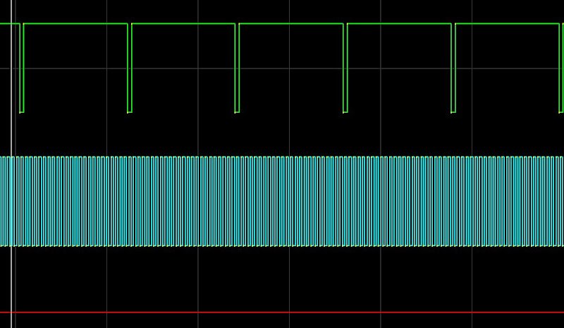

My crank signal was great from the start, but the cam was not.
The red on bottom shows a loss of sync.
This is another view of the bad cam signal
Idle was fine, but as soon as the rpms increased passed 1500, things went funny, I lost sync, and the controller injected fuel for 9000rpm. Simple fix for me. I adjusted the hysteresis on the MS3X board (cam), using the adjustable pot. From fully out, I had to go in approx 6 full turns. You can watch the improvement on the "composite logger" as you turn. Get just enough and stop.
Cleaned up cam signal
Close up of the signals. You can see the 12 crank pulses x2 vs 1 cam signal
Those two items were the only real hiccups I incurred. Got it warmed up, started auto tune, and it's running smoothly right now. Sure there is more cold start stuff to handle, and getting idle control working. Compared to my last system, MS3 was a breeze.
