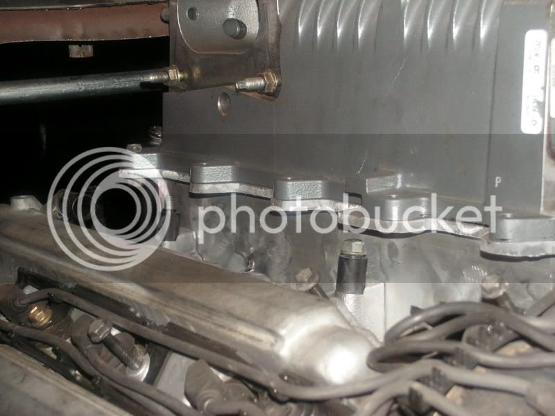

M112 Prep
There are plenty of ports at the back of the supercharger. It’s a tight area when installed so some pre-planning is needed. Lower flange is removed as it would interfere with the manifold intake runners. Taking the front snout off to change the pulley is straightforward, supercharger oil is available through GM for cheap, and you are supposed to use anaerobic gasket maker to re-seal the snout. The stock pulley is not eager to come off but the new one fits easily.

M112 Fitment
The extra mounting lugs etc on the M112 for the Ford install were removed and the case smoothed for aesthetics. The M112 front left mounting leg was moved to accommodate the fuel rail bolt location, however, the M112 is slightly too wide for the original fuel rail mounts. Next time, I would modify the fuel rail mounts and not the M112. It’s hard to tell from the picture but the fuel rails are about five degrees outward of their original positions due to the fuel rail mounting flanges – no apparent operational issues, they work fine. Fuel feed pipes can be re-used with some bending. The rear is easy, the front is ugly due to space limitations. I would fabricate a new front pipe and route it under the manifold next time.
