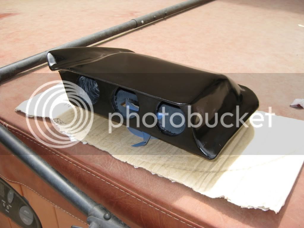

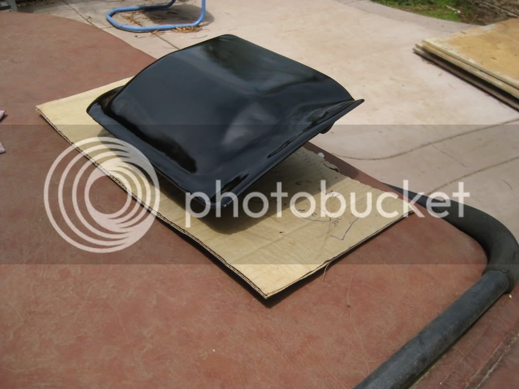

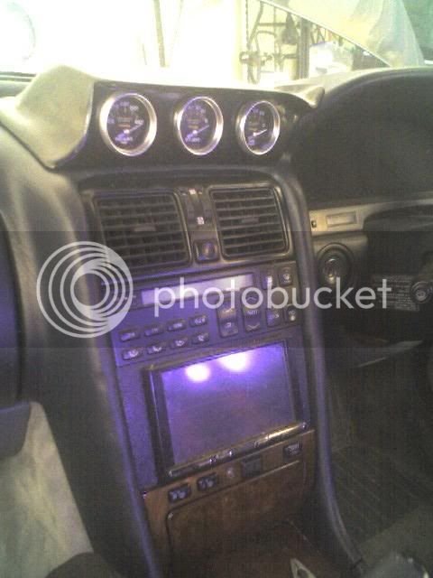

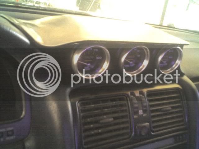

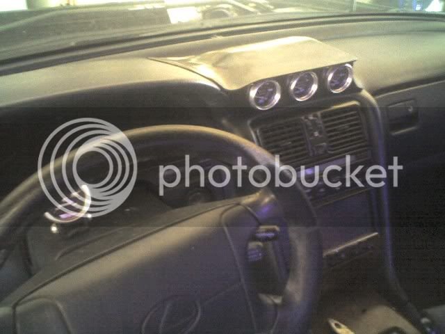

I like the roof of the pod. It sticks out and prevents the glare. How will you attach this pod to the dash? I don't see any screw holes.
Thanks Steve, I realized with 3 gauges at night I might get glare on my windshield and more cop attention. Actually I am working on this right now, been on it the past few days taking my time. I used 2 3/8'' bolts straight through the dash and bolts fit behind the A/C vents w/o modding. I sorta got lucky with my placement. In all there's only 2 bolts in the front holding it down, and with just 2 bolts it's so tight there's no way it will move, so to be safe i'll add a 10'' strip of double sided 3M tape on the other end.
Later tonight I will post some more with the bolt locations and the unit primed. maybe painted.

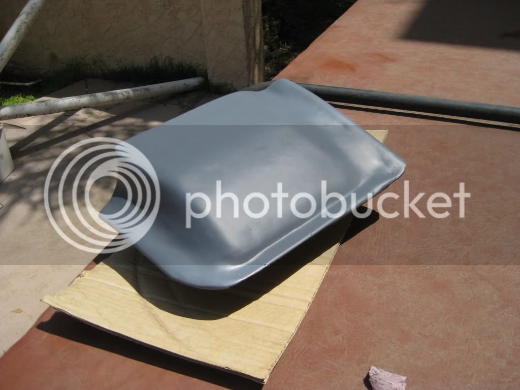

I got a small Q, should I use gloss black epoxy paint w/o gloss coat? Or flat black with a gloss coat? I suppose the gloss black with a gloss coating might be too much?
If you have both the paints on hand then I would try a little bit on something else. This is just to see how it comes out. You wouldn't want to have a Dull or flat black dash and shiney gauge mount. Have you thought about just putting new plastic on the whole dash? It is pretty easy to do. Pull out whole dash and re-finish with new leather/plastic stuff (cannot think of the name of the material) and also do the gauge cluster with the same material. This will look like it is supposed to be there!!:icon16:
suprab808-
I took a blue recycle bin and sprayed part flat and another part gloss, I decided the gloss would look better. It was sort of a dilemma as part of the OEM setup looks flat black and other areas glossy... so I had to contrast before spraying. Just to get as many imperfections out before painting I ended up priming 3 layers and sanded, and primed a second time and sanded with a finishing layer on top. I should have gone through with 320-grit but the 150 managed fine, even replicates the OEM vinyl pretty close lol.
I am still waiting for the paint to dry but once it's ready to handle i'll snap some mounted to the dash. Thanx for the comments guys.

suprab808-
Cool Beans Looks good!!! Can't wait to see it mounted!

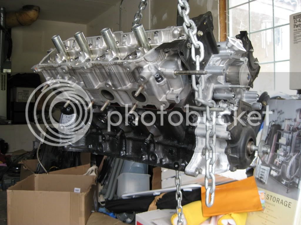

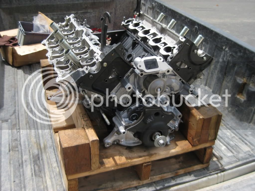

Here are some pictures of the modified 2uzfe for 1uzfe heads. Not the optimium way of doing it but it should work ok.
Well I picked up my complete longblock today and everything looks great. Now I can rest easy knowing my head sealing issues are gone. I used OEM 2uzfe HG's and my builder added a red colored sealant in between for a better/consistent seal, of which I cannot pronounce lol. Now it's back to the tedious job of swapping everything back on and getting the adaptronic in order.
