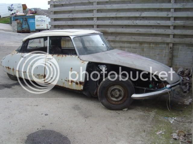

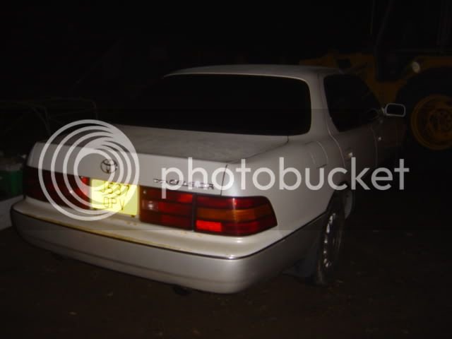

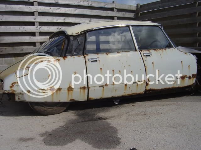

ive collected a few bits , a citroen ds saloon and a ls 400,

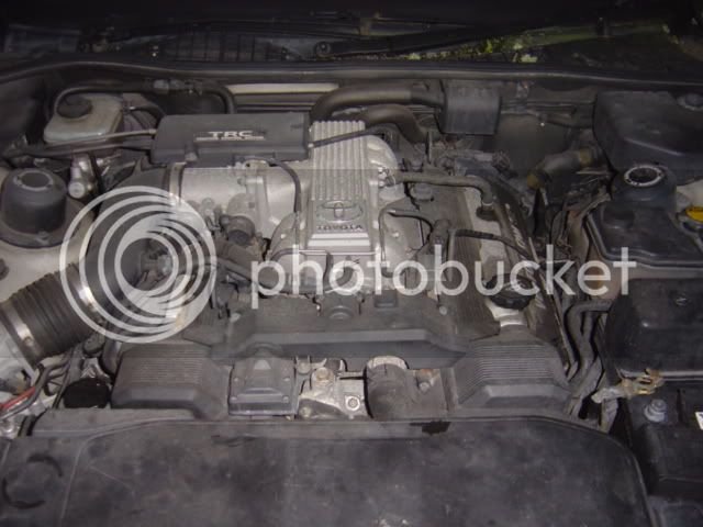

the plan is to graft the front bulkhead chassis assembly into my citroen with the tran tunnel etc, the front track of the lexus will fit under the std arches , the cit is longer wb so will custom fit the rear diff in the back and narrow the track to suit the rear cit arches, then rebuild the front end around the eng to give me mounting points for all the cit body work,
the cit is wider than the lex around the windscreen area so should be able to keep most things inplace.
i bought some 9.5 x 22 wheels and tyres to fit as i had planned on building my own suspension but will save these for another project.
