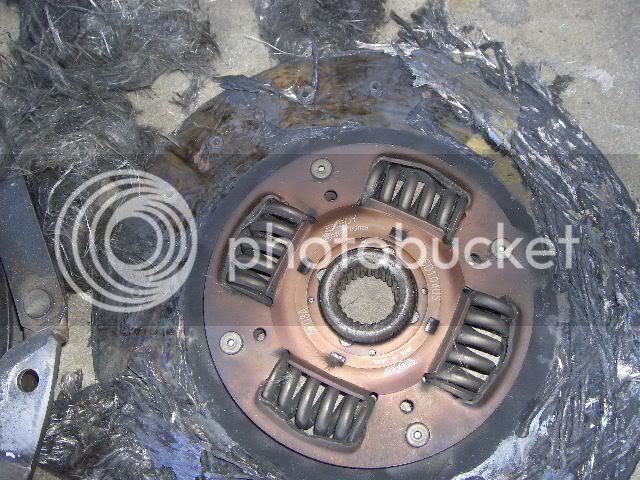

Interesting your Exedy held up, below is the mess mine made on a mild tune car making 500rwhp, good for quite a bit more if I had ditched the F-con ecu.
(Note: the clutch had only been in for 3 days, and had about 48 hours driving time)

500 rwhp on a kevlar plate . Queensland/Australia is full of clutch
experts that push single plate up-rated clutches and quote that they are up to the task. Most will put a new plate on a upgraded std diafram when a multi plate
set-up is what is needed to do the job.

stage 1 clutch on a 500whp car?!?!
you have breached the holding capacity of that clutch. the supra 2jzgte boys are pouting that the exedy multiplate is very good.
actual ratings of clutch torque load is false, or should i say inconsistant between manufactures. i forgot where i read or was told but those figures are usually over rated in some cases.
