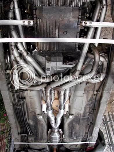

The picture look similiar to what i was think apart from i was think about putting my collectors at the side of the Motors V bank.

How much benefit vs loss would i get from a system as pictured?

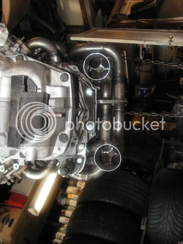

If I were to do it again I would bolt a turbo on either side.

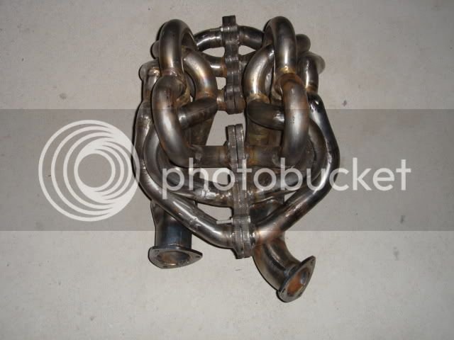

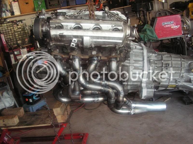

Here's mine. The pipes are 1 3/4", and 38" long, which is longer than I wanted, but as short as would physically work. You will find that it is impossible to have short primaries if they must cross over from one side too the other.
I went this way for the sound. This motor is in a Corolla, and I wanted it to sound different. Not that I have anything against that V8 rumble--I also have a 1967 Camaro with a 327 and I love how it sounds.

All beautiful work, It,s geat to see some one go the extra mile (we all know how long that mile is too) to make a system like that. I love the sound of a 90 degree exhaust system on a V8, the V12 is just to easy to do (just jealous) I did my best to do a 90 degree system on my twin turbo V8 1uz-fe, but it was just to much pipe.
Credit to you Mark;)
