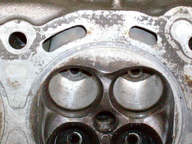

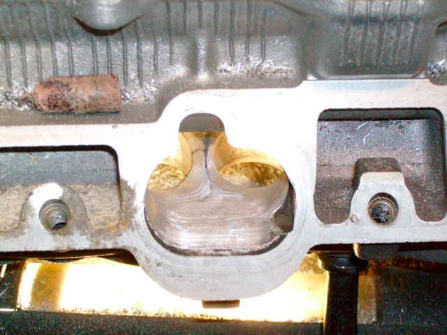

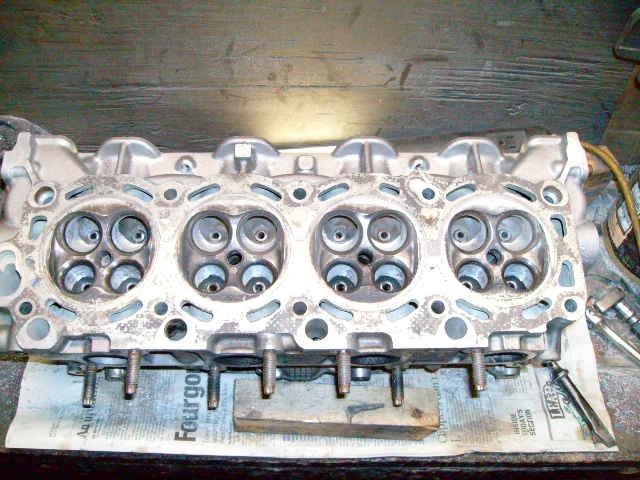

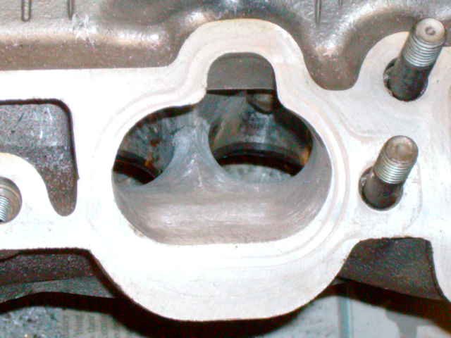

Here are some picture of the head that is partially ported and we have long way from finishing it.
Remember these heads are not done yet.
I took the guides out and got little carried away.. I took more out of the top of the port about where gasket line is..
I see one of the exhaust port bridges has a crack in it too...
One of mine has also...
I'll have to shorten the guides due to extra valve lift..
Alloy really comes up nice when you go over porting with a polishing wheel.. I took the attitude that if I stuffed the porting up I could buy another engine, but all seems well so far....
