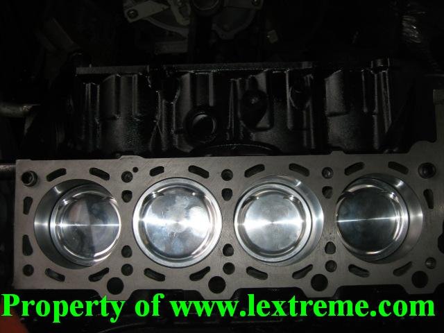

Here is an awesome 2uzfe block from my good friend Wayne. Here are the Pics of the 2UZFE short block attached. Came out very nice....custom forged Ross piston and ring combo, Eagle small block Chevy forged rods, ARP main studs, 1UZFE main caps, 2UZFE forged crank. As you can see, pistons are thermal coated on top and friction coated on the skirts. This block also got 4 bolt conversion too. Wayne plan to run Supercharger, turbo and NOS into this killer motor. We worked together and pioneering the Forged H beam.

Do you guys noticed the piston face/design/configuration of the 2uzfe with 1uzfe heads:
Vs. the 2uzfe piston design with 2uzfe head:
attachment.php
They are both 8.5:1 with very similar setup. However, the heads will be drastically different. On the other hand I will be using Stage III heads. Over size valves, stronger valve springs assembly and cams.
valve reliefs
David...I noticed you only have two valve reliefs in your pistons...is the 1UZFE two-valve or 4-valve? If four valve, are the chambers a lot different than the 2UZFE?
The post 98 V8 engines (all) have similar design like yours (4 valve relief with 4 valves). However, pre 98 has two valve reliefs with 4 valves.
