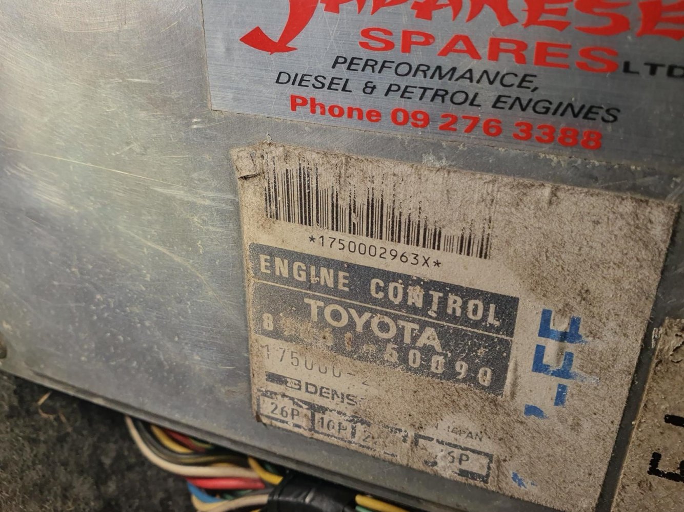

1989 Crown. UZS131 - ATPUK Frame number 004505 (I think)
ECU is 89530 - 30540 (079100 - 1522 12V)
On the ECU label it says 26P and 16P (only)
In fact it is 26 pin, 16 pin, 22 pin and a 10 pin "extra" plug mounted on a bracket (yes, 10 pin, not 8 pin as in the Lextreme diagram).
Also, the transmission (A341E) has two 3-wire sensors on the extension housing, not a 3-wire and a 2-wire. It is a yoke/universal joint coupling.
