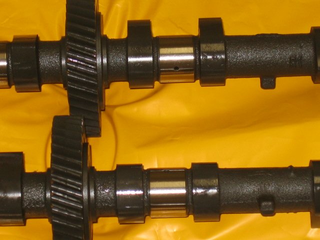

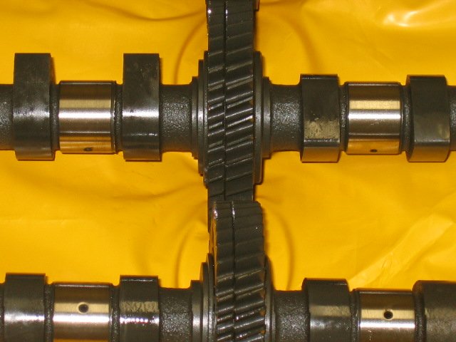

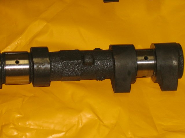

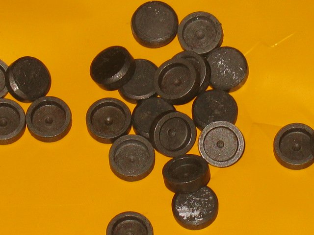

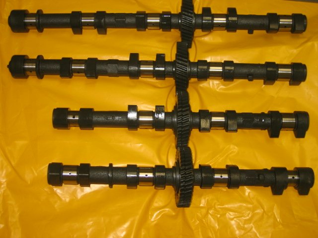

I just got a set of stage 1 cams. They are reground stock cams with slash caps. We are also making a tools for adjusting shim heights and along with a set of shim kit.
We will get some base line dynos and chemical contents (smog station). After cams installed we will get some numbers after along with smog contents.
Once our tool is done, we will do a video on how to install shims.
