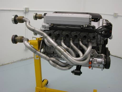

I'm just a big fan of COP's, but with the bimmer's SOHC heads, they're nearly impossible to fit. We'll probably do some CNP's, and if I can afford it, it won't have a waste spark system, but true sequential, with 12 ignition outputs & coils.
I'm a EE, and eliminating those lossy distributors and HV leads makes a lot of sense, although COP's bring their own particular problems to the table too!
I believe someone here is running CBR COP's on the early 1UZ; perhaps The Flea?
